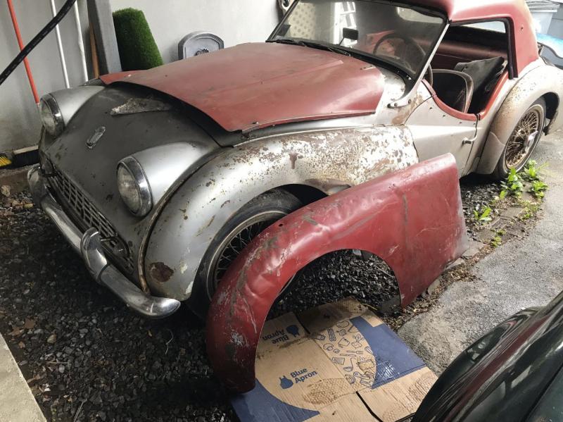

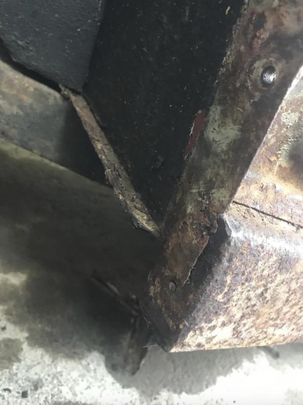

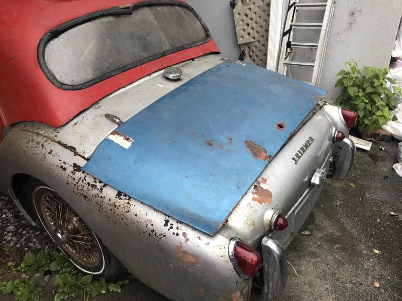

Hey guys!
Is there some space aged goop/paint/treatment that people are using to prevent rust on inner panels/tub/rotted seam areas and such? Im thinking of "encapsulating" rusty seams/corners rather than welding in new bits. Because I suck at welding. I've attached some pics of areas looking at. Inner stuff nobody would see.
Cheers and thank you!

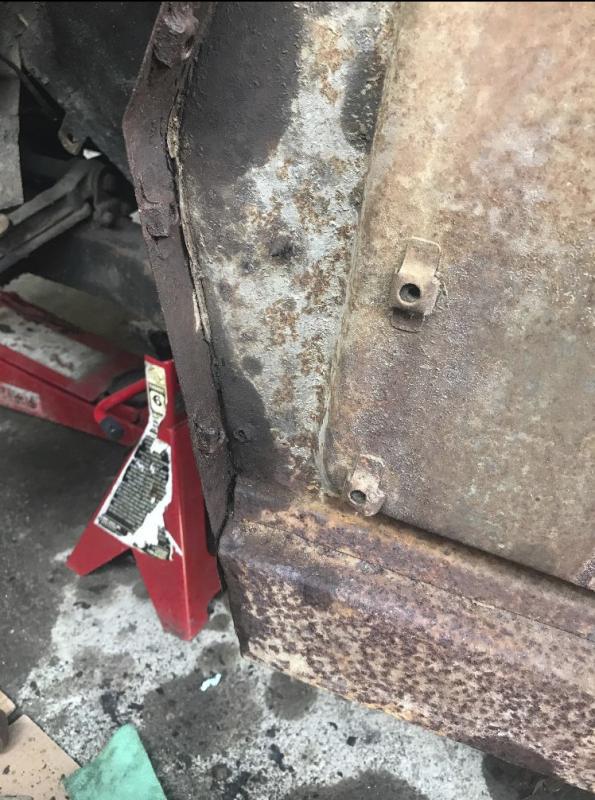

Your car looks very solid to me. The end for the rubber seal is bent in and folded, but should straighten. The last tr3 I did the floor bottom where it meets the fire wall was missing; yours looks good. The only thing I see with your car so far is that it dirty. Are there spots, like the bottom of the front fender, inner sills, or the floor that is rotted? The vehicle I am working in now I am going to use some encapsulating products also. The last one I did I totally disassembled--- but it always depends on many variables and time being a big one. I need to see more of your car before I can formulate a complete opinion, but from I see I would not cut it up for welding.
L
lordwestbrook
So the car is pretty rough overall at first glance, but structurally pretty sound, save for a decent sized hole in the pass side floor. The Scuttle has rot at the ends which I wouldnt know where to begin replacing/repairing at the moment, maybe I'll address that at a later date after she's up and running and I've had some fun with the car. Since I just don't have the time to do everything correctly (cutting and welding) I think I'm going to try the rust encapsulator route where needed.
Thought I've only gotten into the front drivers portion so far on this can of worms. More pics TK as I peel this onion. I really want it to stop and go safely, not at all really concerned about cosmetics I just want to drive the heck out of it.
