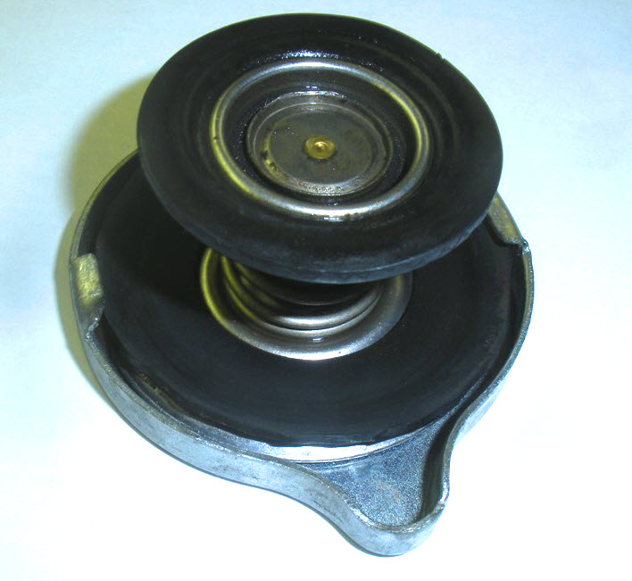

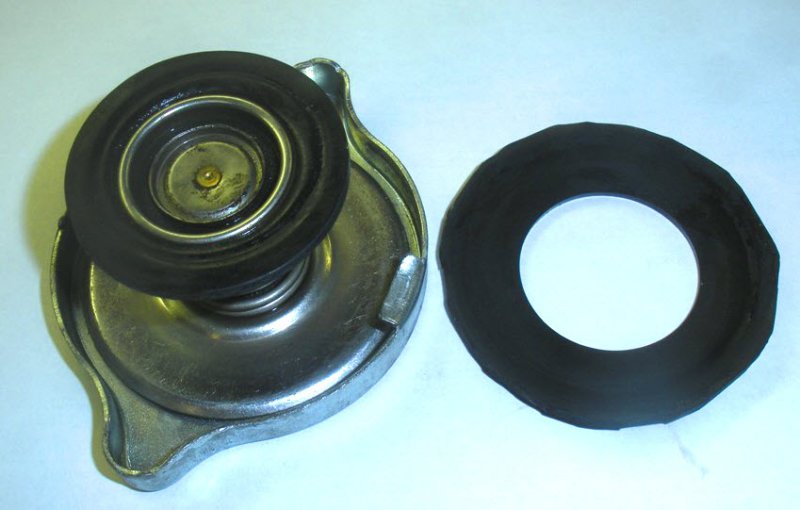

One thing - the stock filler cap can be made into a recovery cap with the simple addition of a home-made rubber gasket:
Don't ask me how this works but I've been using it for years.
