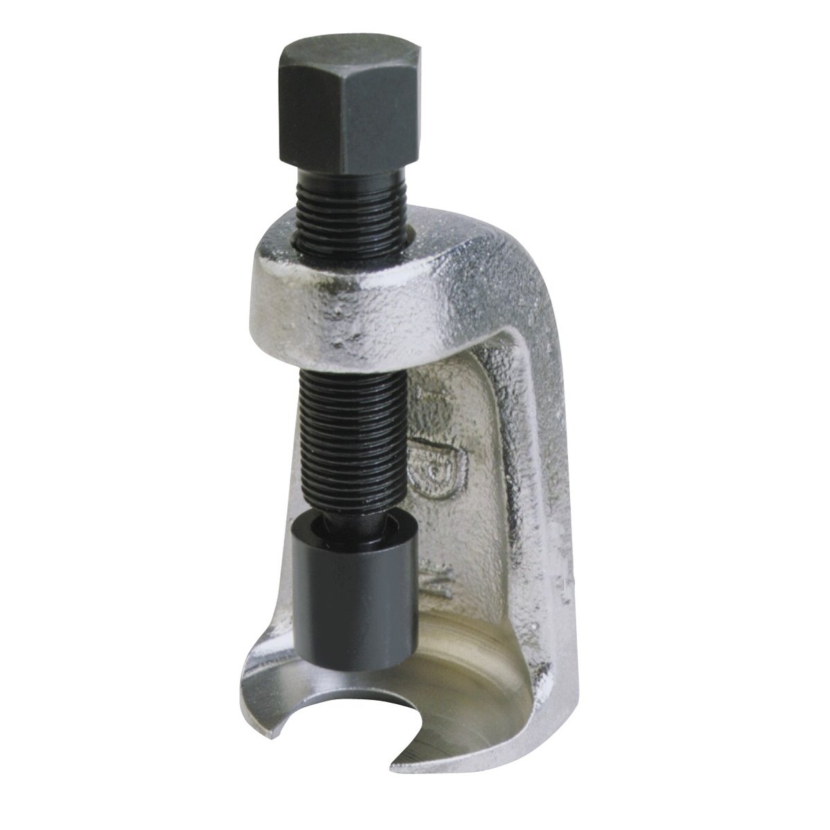

Ouch, you might try picking up a puller similar to the following.
I have one similar to this that always worked well except on one older RX7 where we had to use heat in order to get it to pop free.
