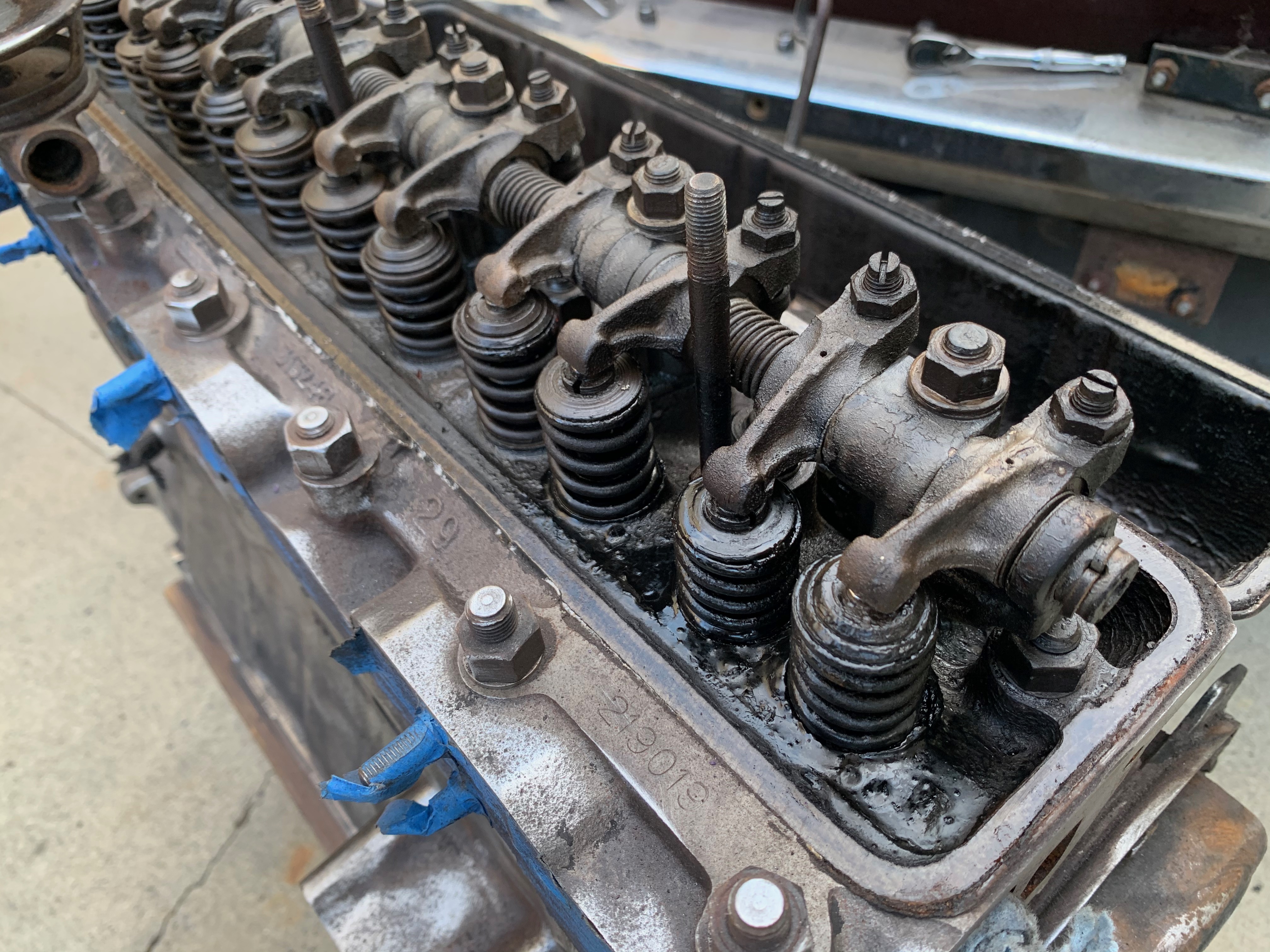

Hi all, I'm still working through a light engine rebuild and had the valve/rocker cover off yesterday. I noticed there was a lot of sludge collected at one end of the engine. My first though is that this engine has just sat for 20+ years and it's probably just old oil. But wanted to gut-check here with the experts in case it was something to look out for as a potential issue.

Good question I just pulled the head off TR 6 today on a motor that has sat for as many years maybe 20 years also. it was not like yours much cleaner for sure. There was no history of the motor but was quite rich with carbon on plugs and piston head.
At first look at your head I would say there was a lack of enough oil to the rear of the rockers. Slug should have been more even as the oil should all drain down the galley to the pan.
Fact: One- 6 cyl motor will be hotter to the rear of the block as yours shows. Two- Oil to the top of the block and or head is slow as oil pressure gets oil moving. TEST take the oil filler cap off the cover and start a motor from cold and see how long it takes until you see oil coming from rockers that hole on the top of the rocker. Three - when you complete your work add a line to the top of the head. NOTE At the rear of the head is a bolt the allows a line to be added from the oil pump area.
Slug build-up comes from lack of oil changes as oil breaks down, the additives in motor oil act as cleaning DETGERNT OIL to filter
When motors sit for a long time either inside or out oil will go away and leave parts dry you may not have rust but lube the as you expose parts. I would guess your rocker shaft may be quite worn and need be replaced and a few rockers also. Check for the amount of wear.
I removed the studs and used wood wedges to raised head until we lifted it off. It will be tight to free up.
Take your time it will all come apart with some WD 40 Hope that helps add pic as you go.

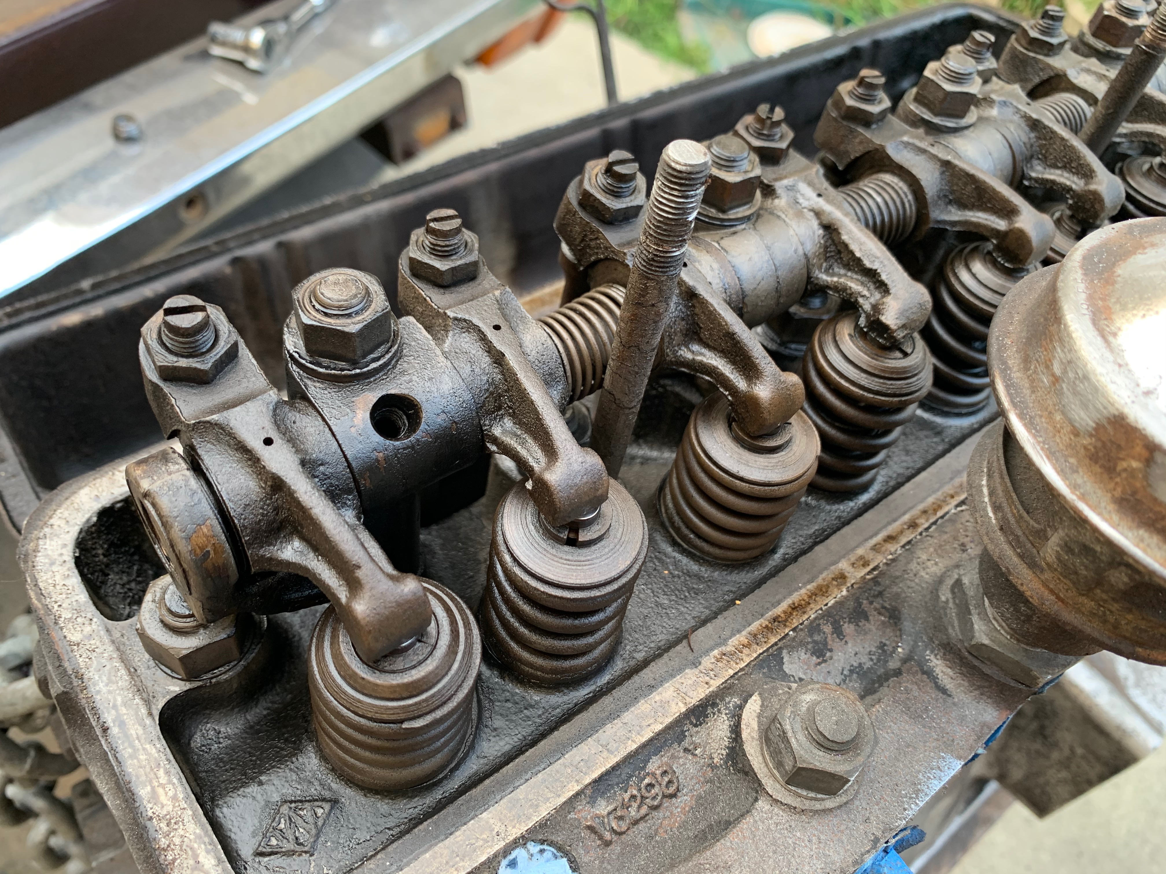

You know 'that screw' is missing from the rear pedestal ?

Hmm I had noticed that some of the rockers seemed a little loose. I didn’t know what was acceptable play but was going to check later. Thanks for the heads up.
And I noticed that bolt at the end and wondered what it was for! That could be a great idea to run some more oil up there!

Sludge like that happens when old mineral oil is run for short distances without letting the engine come up to temperature. I have seen the valve cover completely packed with sludge like that. Synthetic oil does not turn to sludge like that, but it will get a milky consistency if the engine is never run at operating temperature.

Are your plans to start the motor? If so, drain the old oil out leave the drain plug out and pour a couple of quarts of oil over the rocker assembly then let tall hat oil drain out. Next put the drain plug back in and fill to the mark with oil. Undo the coil so the car does not start and crank the engine to get oil pressure. Then hook the coil up and see what it sounds like. Oh put that screw back into the shaft and maybe look around with a flash light to see if the screw logged somewhere by a pushrod or wherever.

It keeps the rocker shaft itself from rotating...If the shaft rotated the oil ports will not line up with the rocker arms...plus if 'that screw' is missing oil will gush out of the hole.
Oh! Wow that’s good to know! It’ll check if it’s rotated!

That’sa great idea. Yes I’m be starting the engine hopefully by the end of the summer. I’m assuming it needs to be similar mineral oil in order to break it down properly?

Most likely the rocker arms and shaft are unusable if the engine has been run without the screw in the rear pedestal. Also, it seems like most peoples experience with the auxiliary oil line has not been positive and diverts oil from the lower engine. Apply the money not spent on the oil line to replacing the shaft and replacing or re bushing the rocker arms.
