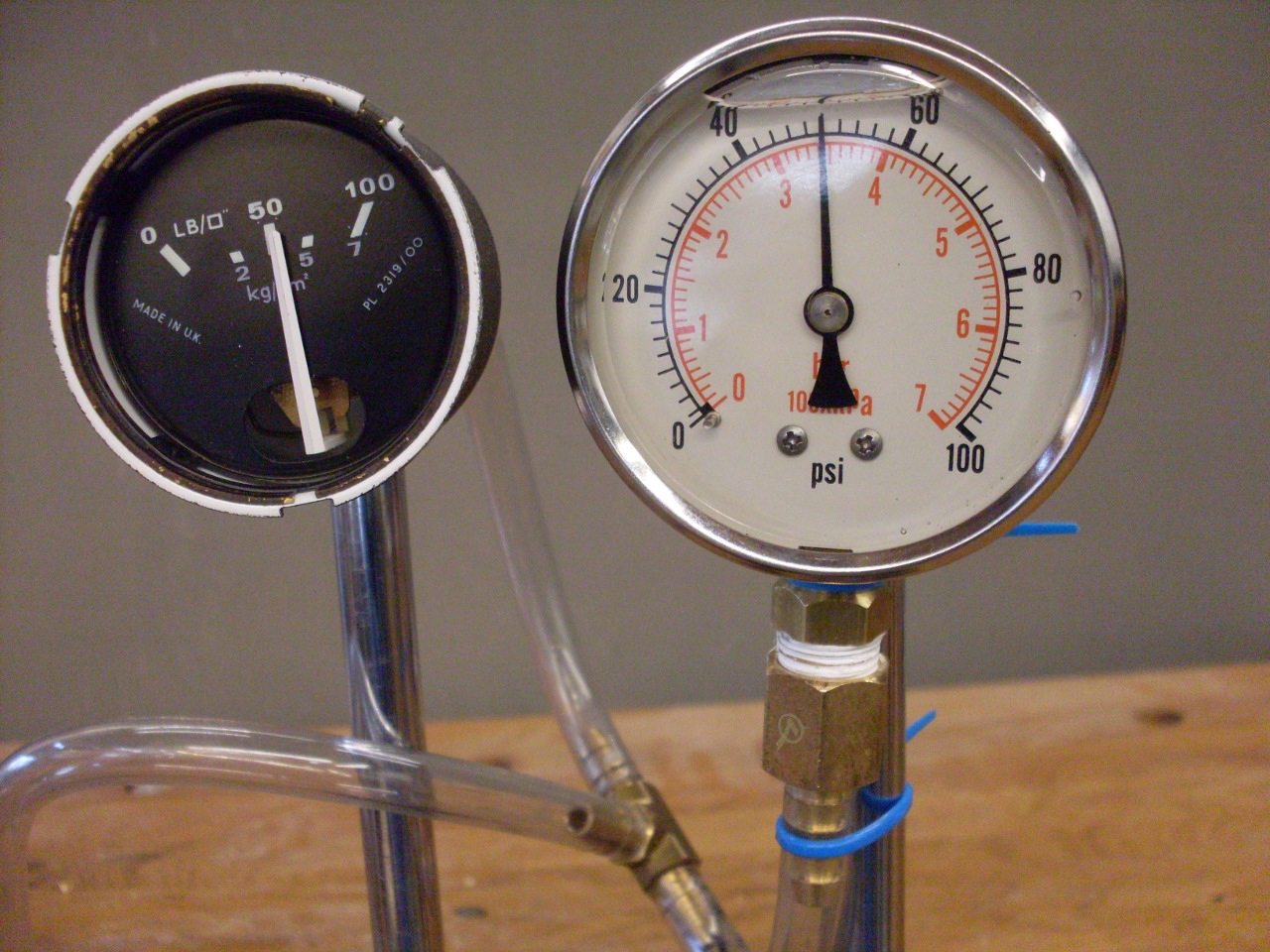

I plan to remove my oil pressure gauge for cleaning (66' TR4A). While it's out, I'd like to test it for accuracy. Any good DIY ideas on how I can do this? I tried some searches but, came up empty

Connect it to a tire of known psi?? You might have to McGyver the connections…

Humm. That has possibilities Mike. I have a portable air pump which has an air line with a schaeder valve on one end and a quick couple on the other. I could use a donut spare tire which are usually inflated to 65psi
Mezy, yours is interesting too. HF has a $30 oil pressure gauge kit I could try and plumb-in.
I think my biggest challenge was finding a method of generating pressure
Any other ideas welcome.

Tee off the feed pipe feeding the original gauge and fit a gauge to each pipe, if the two gauges read the same pressure they cant both be wrong.
failing that try a foot pump with a gauge on it and see how the two gauges compare.

Bingo! It may be a couple weeks before I can get to this but will definitely circle back and advise how I made out

So complicated...I've always just used the rubber nipple on an air hose. But it sounds like you don't have a compressor?

I think I just used one of those hand pumps.

I took 2 oil gauges and used a T fitting to check out oil gauge pressure and calibration when driving. It worked fine. The only problem was getting some of the brass fittings for lines and fittings. I actually mounted them with 2 hole gauge holder and drove around. I found one of my gauges read very weak and no gauge read too high. All the gauges even the new ones seem to have 2inch diameter, so you can put a new gauge next to an old one.

Ed, I like it. That's a very neat test rig. A few cheap parts does the trick.
