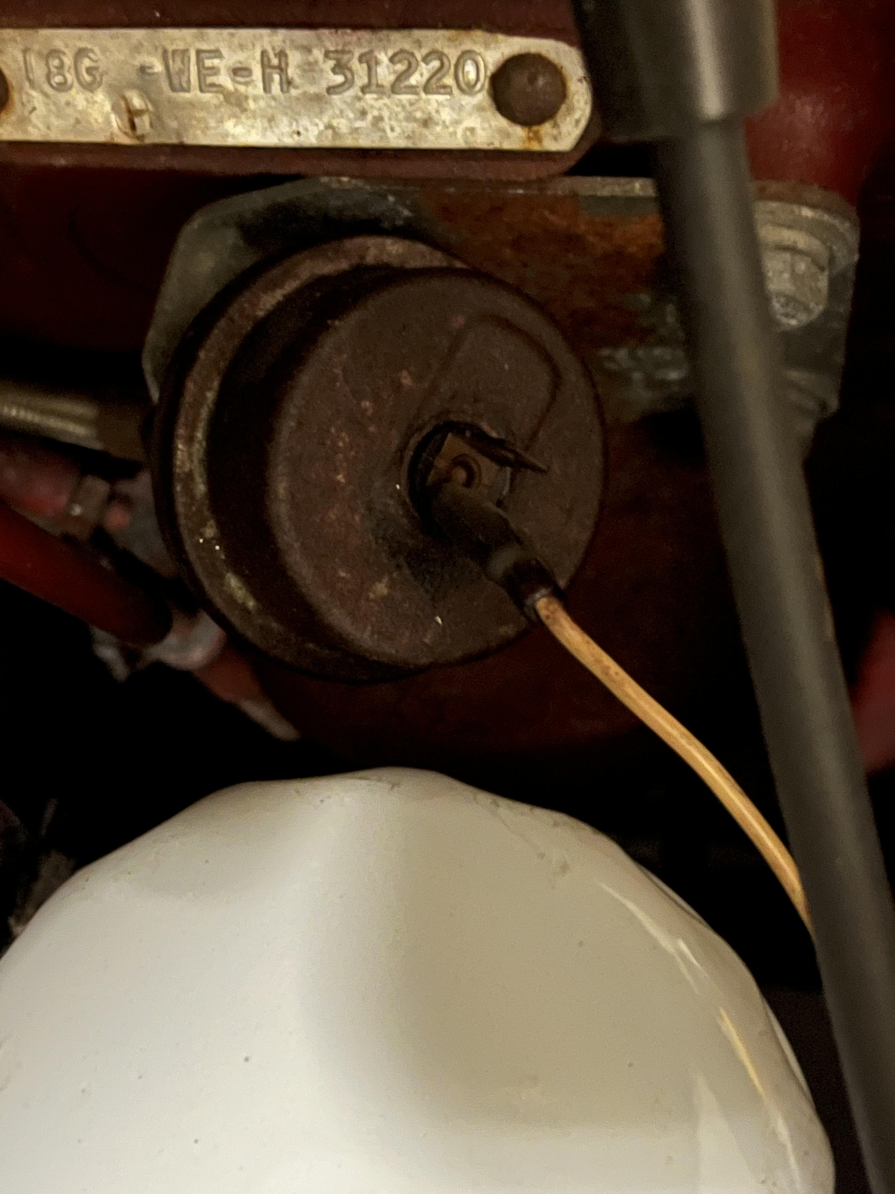

Is this it? One wire and looks similar (but a bit different) than the part I found from a supplier.

I confirmed that's the sending unit by unplugging the wire and watching the pressure gauge go to zero. Then my son and I shorted the wire to the frame and watched the gauge climb. The better he made the electrical connection, the higher the pressure reading, so I think the gauge is okay. I ordered a new sending unit.
