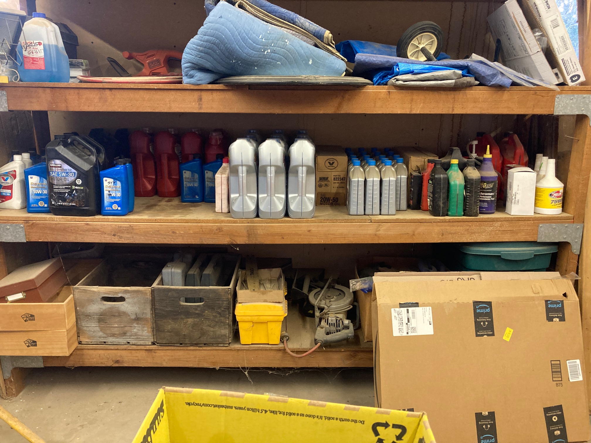

I look for sales and stock up.

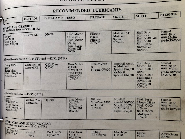

This manual covers all Healey 6-cyls (including BT7s):
From: > Austin-Healey 100-Six and 3000 Repair Information 1956-1968 - Bentley Publishers - Repair Manuals and Automotive Books <
From the Bentley manual:

I use Valvoline VR-1 20W-50. As shown by Bob, the Bentley manual lists 20W-50 for the 6-cylinder engine and transmission at temperatures at or above 41F. VR-1 has the correct amount of ZDTP and a low viscosity index.
