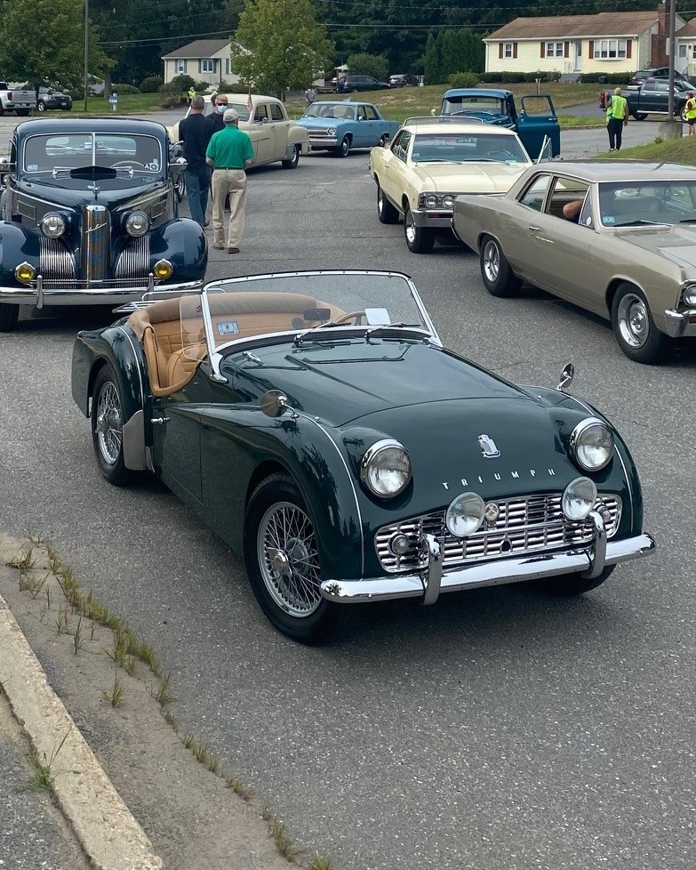

Hi all, I'm new to the BCF. I bought a 1961 TR3a from my uncle last year who did a complete restoration on the vehicle and enjoyed it for 10 years himself. He has relocated across the country so even though he is only a phone call away, its been difficult to tinker with and fine tune the car without him. After putting the car away for the winter, I had to have the carburetors rebuilt and tuned this spring. It runs great until I come to a stop, and the rpm's are at around 1,000 then it wants to drop out and stall...…even when the car is hot and has been driving for an hour. If I pop the choke it hops back up to 1,000 rpm's and idles fine. My mechanic cant figure it out...and said I should invest in Weber carburetors. I'm mechanically inclined, but still green when it comes to this car so any advice on the problem I'm having or the Weber upgrade would be appreciated! Thanks,
Brian

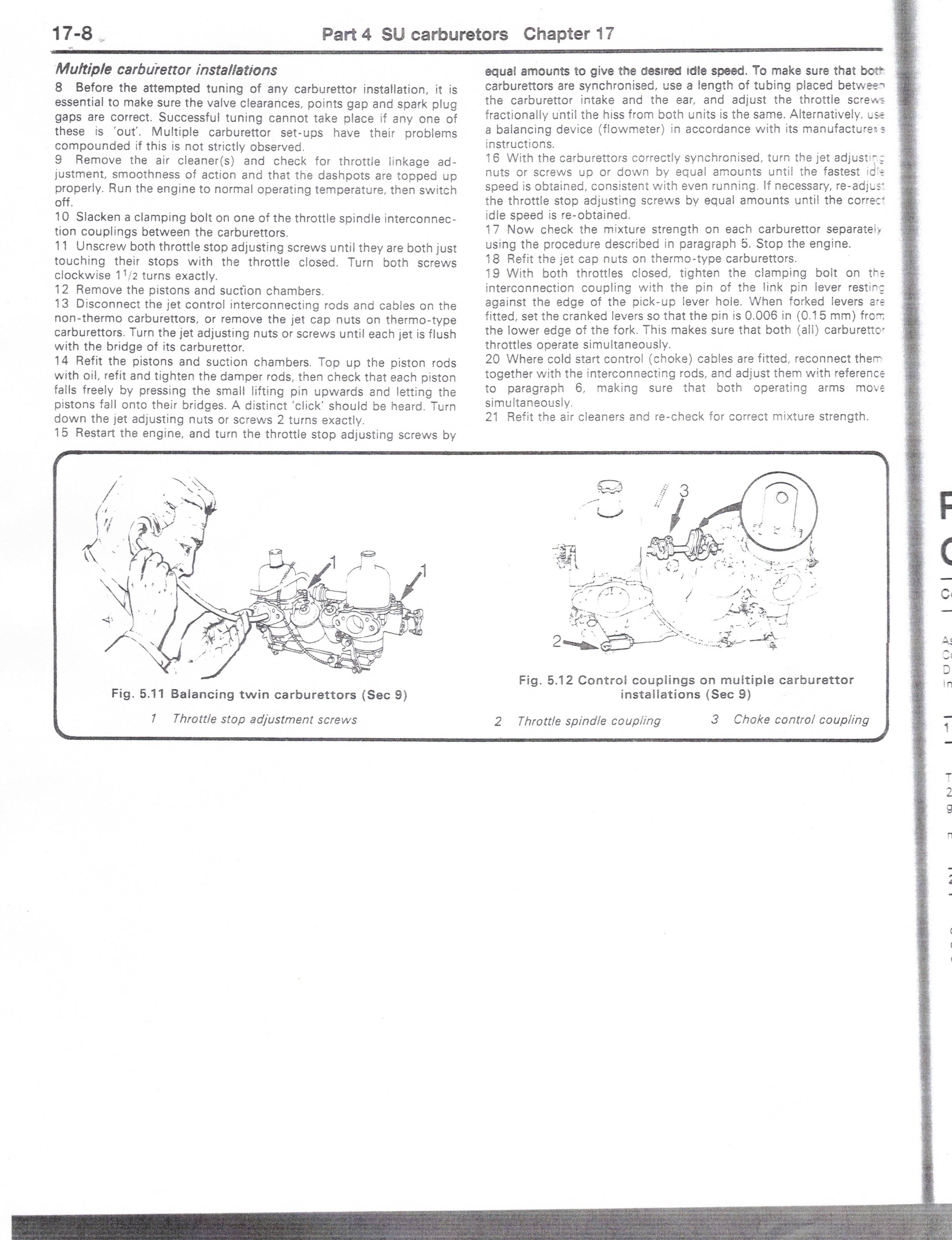

Attached are two pages instruction for adjusting SU Carbs for TR3. This is out of the Haynes Carburetor manual. The sections and figures I note on Page 1 are the key. First of all, as mentioned above, be sure to thoroughly check out the engine electrics. And also, balance the air flow of the carbs, see figure 5.11. I found Figure 5.9 very helpful in conjunction with the items marked (w), (c), and (r) in section 5 in the first column. It takes some time and close listening to decipher the sound of the exhaust but it is very accurate. ( I did not find the section about pushing the lifting pin helpful at all, just didn't seem to work right). I also closely observed the color of the electrodes on the spark plugs. Over quite a long time of tweaking and driving I found the best setting for the jet adjusting nut (see figure 5.7). If the spark plugs were too black, I'd turn the nut clockwise to lean the mixture, (i.e. 1/2 to 1 flat at a time and then drive). If the spark plugs were too white, I'd turn the nut counterclock wise, (i.e. 1/2 to 1 flat at a time and then drive) to richen the mixture. Once the spark plug electrodes were a nice shade of brown and the exhaust sounded right (Fig 5.9), I found that is when it ran the best. As I mentioned, it took me some time before I reached where I wanted the carbs to be.
Bob
