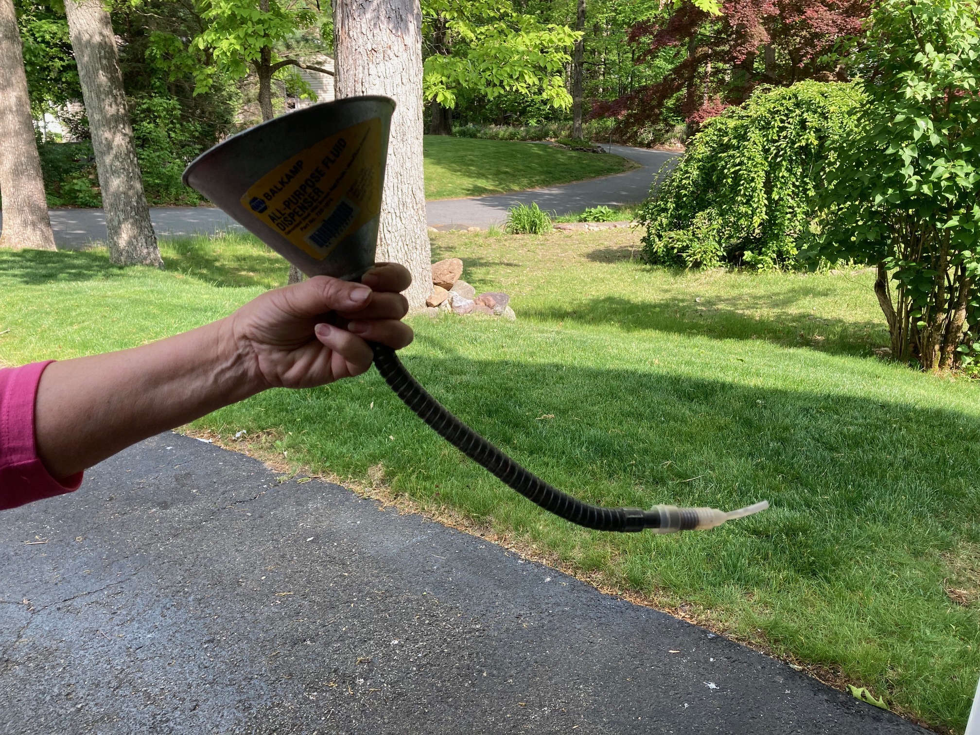

Hopefully attached is a little device I cobbled together to assist in the sloppy lever shock refilling process. The little tube end is from a cheap plastic gas siphoning kit. The ends are similar in size but this one is the smaller and fits over the flexible metal tube and easily fits the shock refill opening. Afte bathing myself, the suspension and the garage floor, this tidbit worked. Maybe someone can refine it but as the old adage says; K.I.S.S....Keep It Simple Stupid. MG lever shock oiler.jpg
