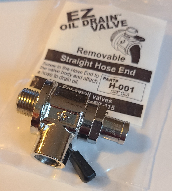

It works and, importantly to the owner of the concrete I park on, being a ball valve and sealed with o-rings in machined grooves, it does not leak.
EZ-101 is the valve and and H-101 is a 3/8 inch OD straight screw-in nipple. I just put empty 20 oz bottles -- 'cause they fit without jacking the car -- underneath and drain the warm oil into them. We burn the used oil in space heaters but it could easily be recycled.

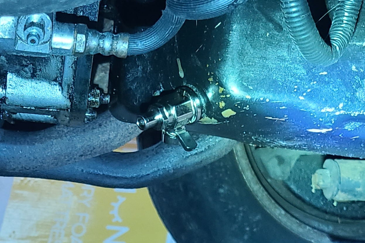

Installed valve.

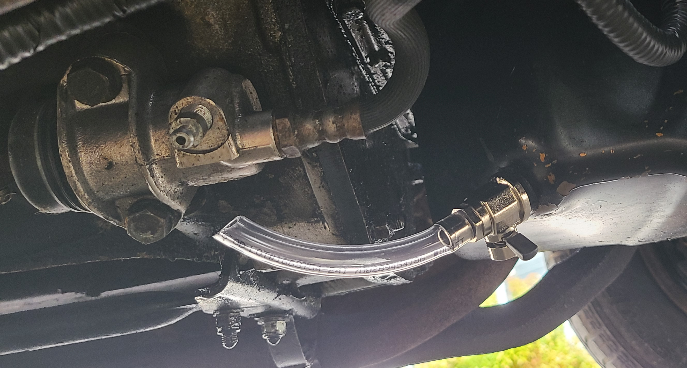

With 3/8 inch ID clear plastic (air conditioning drain) tube (about 3 inches long).
