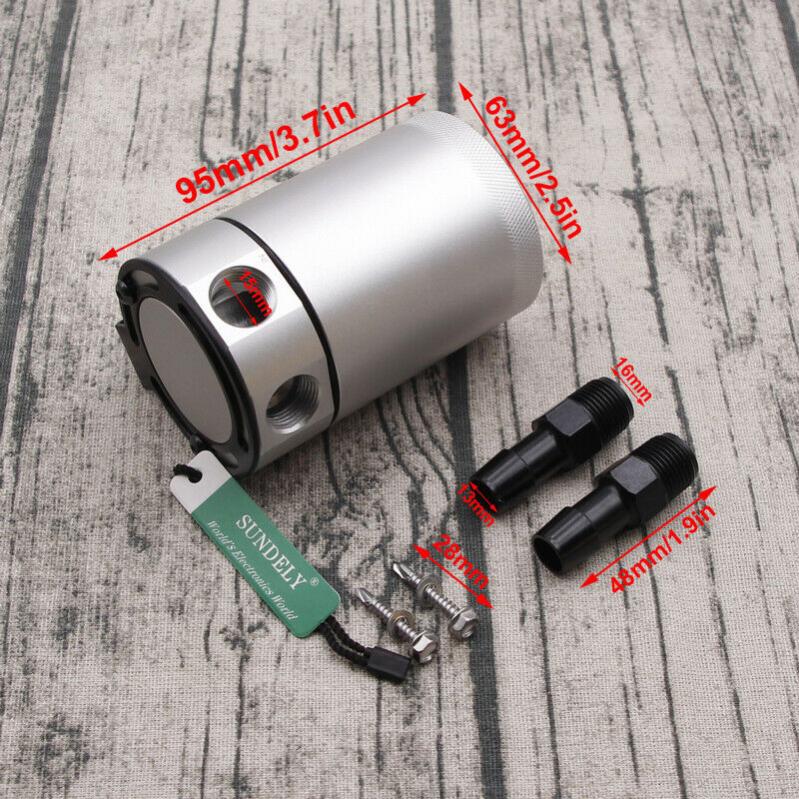

Whenever I check the carbs on my BJ8 I notice that the piston and the air filter on the rear carb has a film of oil on it and the plugs for the rear bank of cylinders are usually blacker than the front. I guess this is caused by oil mist coming in from the breather pipe connecting the air filter to the valve cover.
So I've been thinking of fitting a catch tank. My question is, how big do they need to be. I don't have a lot of room in the corner behind the rear carb and I've found quiet a compact looking catch tank on Ebay which would easily fit in the chassis void under the air filter. It holds 2 fluid ounces (Imp). My car doesn't seem to use much oil. I do about 2000mls a year and very rarely have to top the sump up, I think I only did it once last year with 1/2 litre in all.
Has anyone else tried this out? Does anyone have any advice as to whether this is likely to cause any problems.

It needs to be a baffled tank otherwise it wont work .
I have a small one waiting to go into my 62 rally recreation . Its about 6ā€ tall 2 1/2ā€ diameter .
Size doesnt matter (keep it clean the mods are watching) you will just need to empty it more often and it depends how ā€œenthusiasticā€ you are as a driver .
Lin
Looks like your catch can is a Mishimoto. It is baffled. They also make a drain valve so you donā€™t actually have to disassemble the can to drain. Very handy. I have one on my car.

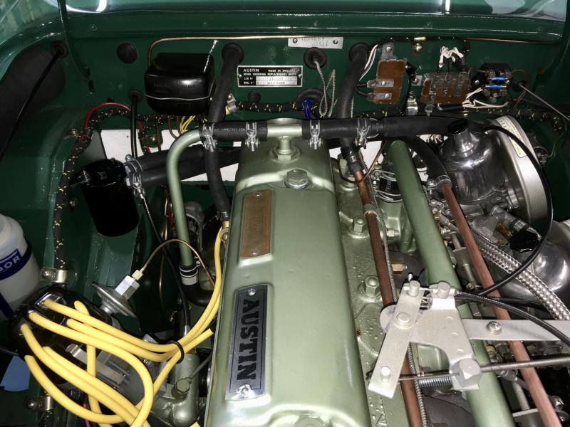

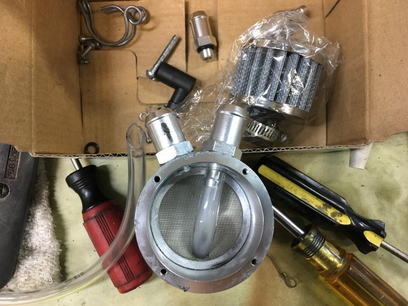

i looked at a number of catch cans. a lot of them i could not understand how they were going to work. it looked like the air came in and went out with out passing thru any time of filter or screening... or could get around it. granted i looked at cheaper ones. i finally bought one that the air comes in, goes thru a tube in to the bottom and is pulled back up to go out thru a filter. i put mine on the left side and ran the hoses to it. easier to get to and drain with the valve on the bottom.
i added one because i added a PCV valve. i have not put on a lot of miles this summer yet but so far have not gotten enough oil out to get a good drop. i may also put a SS pad in the top for an extra filter. also i was getting too much vaccum in my crank case so i added a filtered air intake to my system. this may help cut down on the oil being pulled out.fullsizeoutput_2c3.jpgfullsizeoutput_2c8.jpg

i wonder if most of your oil spray is getting pulled out of the side of the engine and up the verticle vent pipe. there is a lot of oil being sprayed around down there. i was wondering if taking off that verticle pipe and just putting some SS pad in the pipe. it could shed off of that and run back in to the engine.
the vent on the valve cover i believe has a baffle there and there is less oil in the top end.
maybe someone else here could say whether there this would or would not work... but it may save having to use a catch can at all.

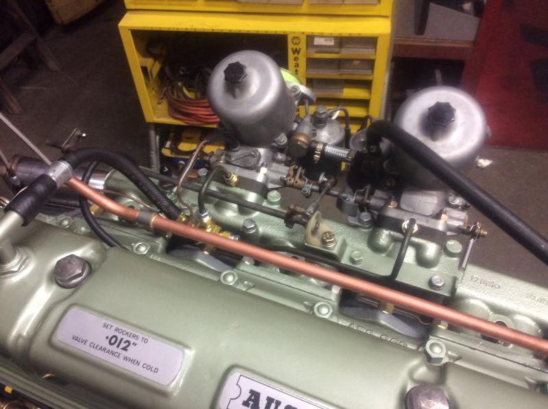

Hi AJ,
I created my baffled catch can prior to deciding not to use a PCV (because of the confusion in the valve's required capacity and how to identify one with that proper capacity). However, I did install the catch can mounted behind the rear carburetor and connected between the original breather hose from the valve cover and rear air filter. Since the purpose of this process is to provide easy evacuation of combustion and oil contaminants from engine internals for elimination through combustion, I figured my baffled catch can will condense the heavier of these gasses and oil particles for manual elimination. This process intervention has eliminated these contaminants prior to their screwing up my rear carb or cleaner, with a very small amount of oil like fluid captured.
There are a couple of things I have learned. I was told the catch can should be mounted below the evacuation pipe. However, I could not clarify this by identifying which hose was being referenced (crank case or valve cover). Additionally, if installed below the engine (i.e. on the frame near the rear of he engine), could there be a siphoning effect?
Additionally, I have seen where a valve-controlled extraction tube can be easily installed and be very convenient for on-going maintenance operation. Since the oil will be manually eliminated, your carburetor should stay quite clean from this form of contamination
Al-in-all, here is a picture of my installation, As mentioned, it has kept my rear carburetor quite clean and with very low maintenance required.
Hope this Helps,
Ray(64BJ8P1)

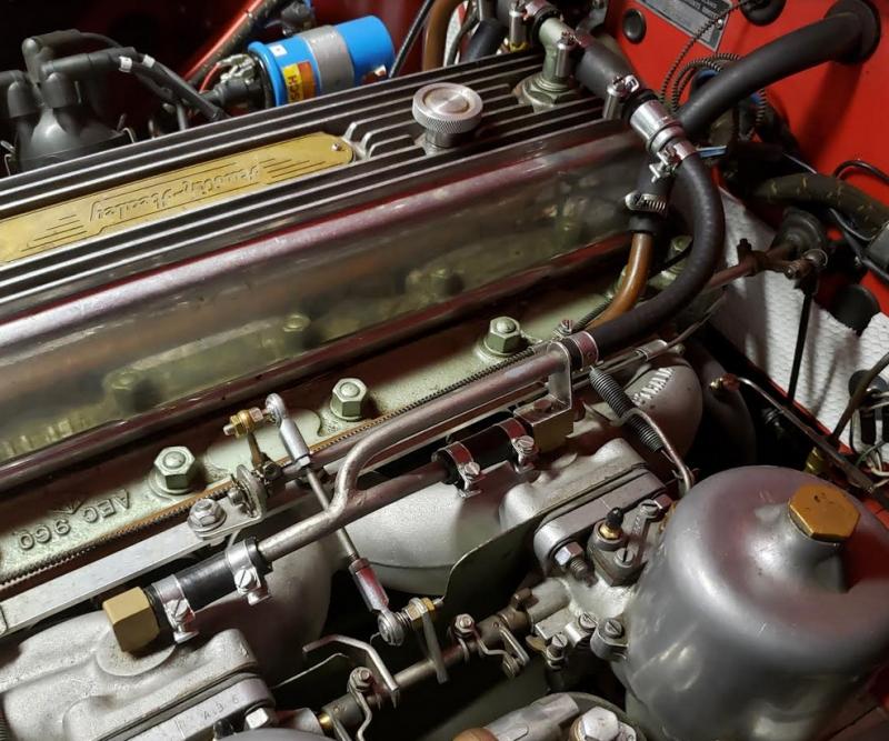

I agree with Dave, no baffles are needed. My tank is under the wing behind the front wheel. The Healey engine intake was not designed for PCV valves, fitting them is just a ā€˜bodgeā€™ job.

Thanks for the input, I've just ordered it. I'm going to remove the windscreen washer bottle and put it in the bottle holder.

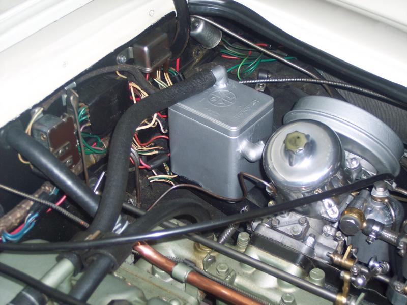

As a matter of interest, I fitted a PCV valve to my 1954 MGTF. I've not fitted one to my Healey as it doesn't loose a lot of oil. I fitted a try to catch the odd drip so it doesn't leave traces on driveways.
To reduce the depression in the crank case I put a restricter in the pipe from the crank case. It was a 1" piece of solid steel rod rammed into the hose. I drilled a small hole down the middle of the rod. I had to experiment a couple of times to get the hole diameter right. Worked fine.
