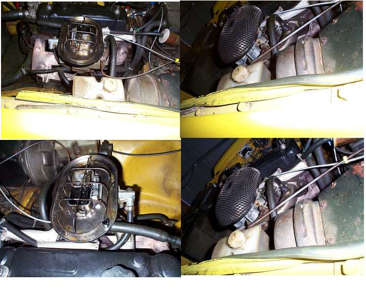

Does anyone have a pic of a Weber downdraft carb installed on a 75+ MGB? I am trying to figure out where to run vacuum / water lines etc and a good pic would be worth the proverbial!

Some pix of my 78 carb

Excellent - thank you so much.
Just to clarify - does the vacuum line from the servo attacht to the manifold to the right of the carb (top left pic)??

The car is about 100 feet away and it is dark and raining and my garaqge light isn't working, so a further check will wait til morning, OK? But I am sure the hose arching over to the manifold in the lower right picture is the brake boost vacuum line.

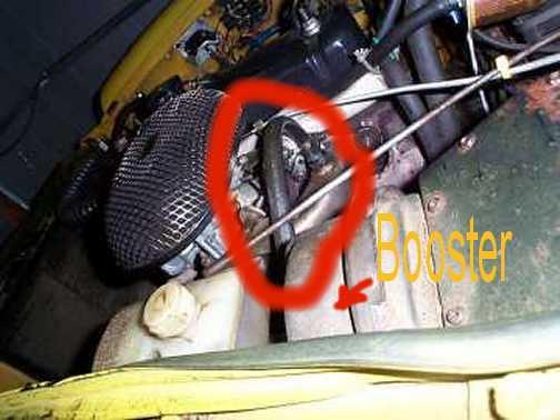

I have circled the hose and fitting and also pointed out the booster. Firewall is to our right. Yeh, I know it is overkill!

Simon, I just couldn't let it it go. Had to go out and check that hose. Yes, it is the vacuum hose to the booster. It goes down and has an ell fitting into the booster.
Good luck and if you need more pix, just ask. PM is OK, too.
