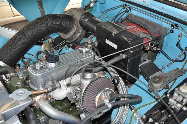

I'm quite pleased with the performance of the single HIF6 SU
on my 1380cc motor. It's smooth and responsive.
A professionally prepared set of twin SUs like our friend Hap
sells would be my choice if I were starting over however.

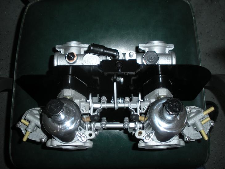

Well, since everybody has given their opinion, I will too :smile: I'm partial to the twin SUs, they just look right, and SUs are very simple carbs, so easy enough to tune for most folks, so if you want to rebuild what ya got, here's what I can do with them.
