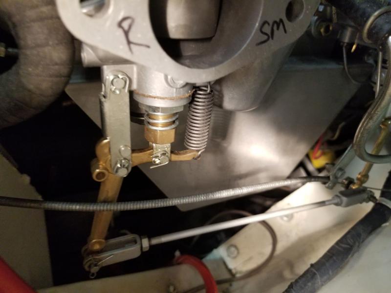

I need a sanity check here. I took the carbs off to refresh, upon installation of the linkages I have one extra attaching pin. I have the choke properly secured, the linkages between the carbs are adjusted. Does anyone see an issue with the way I have everything connected in this picture? Everything runs fine, I need to figure out where this piece goes.

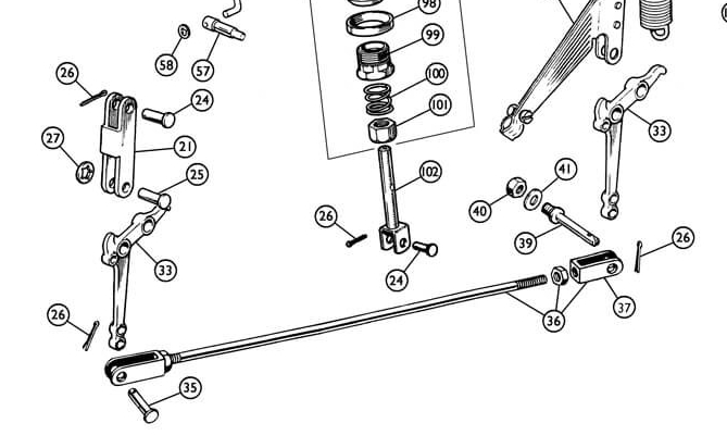

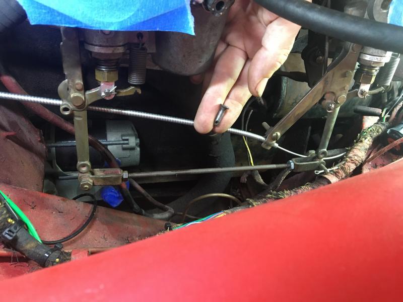

I seem to remember that Randall pointed out that the front clevis goes on the outside that is why the pin is so long.
