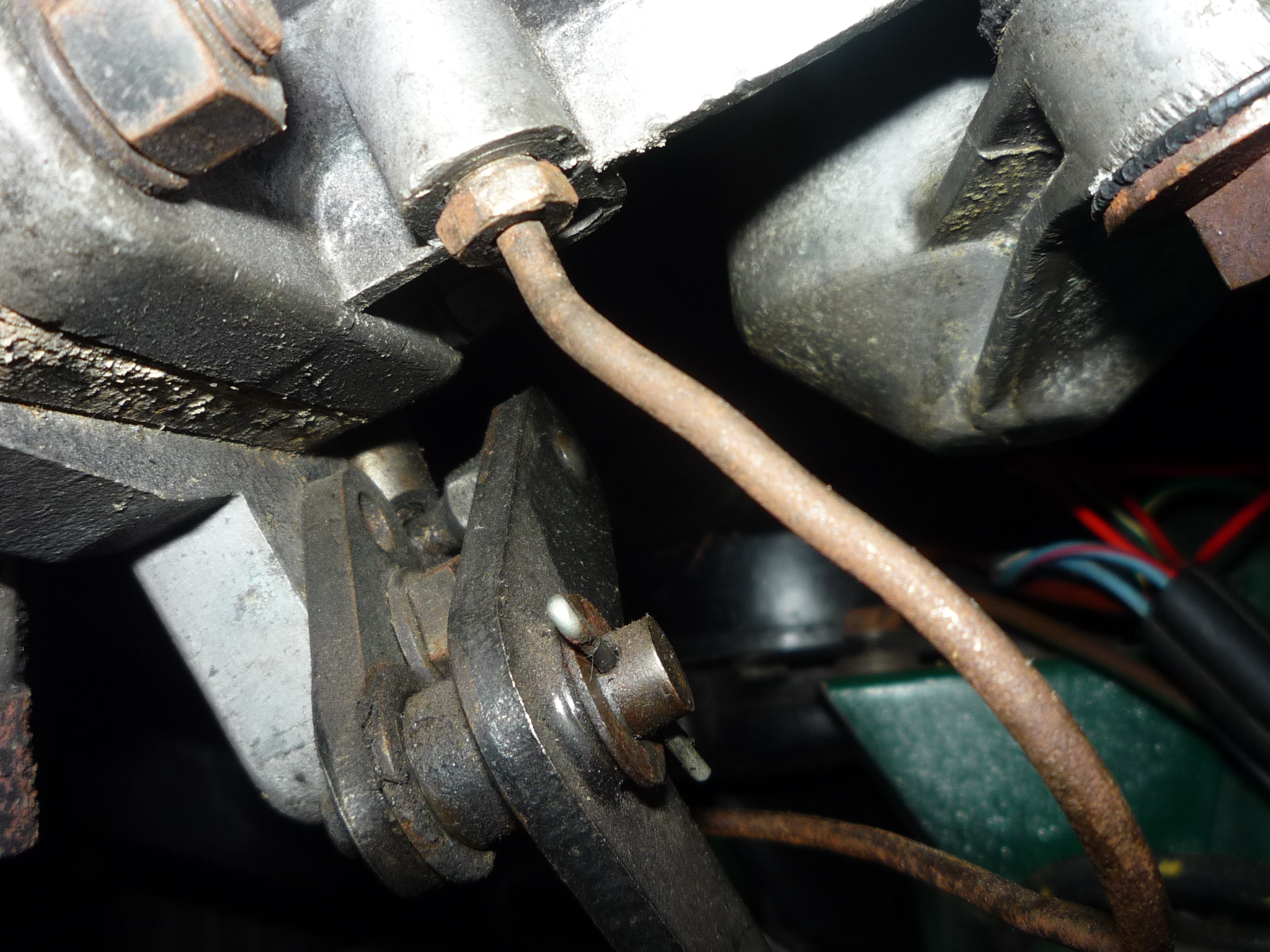

Here's how it attaches to the underside of the front carb in my mid-TR3A. Earlier cars had a brass union in the carb and the line has a screw-on fitting like is used on the vacuum advance. Maybe that was for the TR2 - I have one and will add a picture when I find it.
