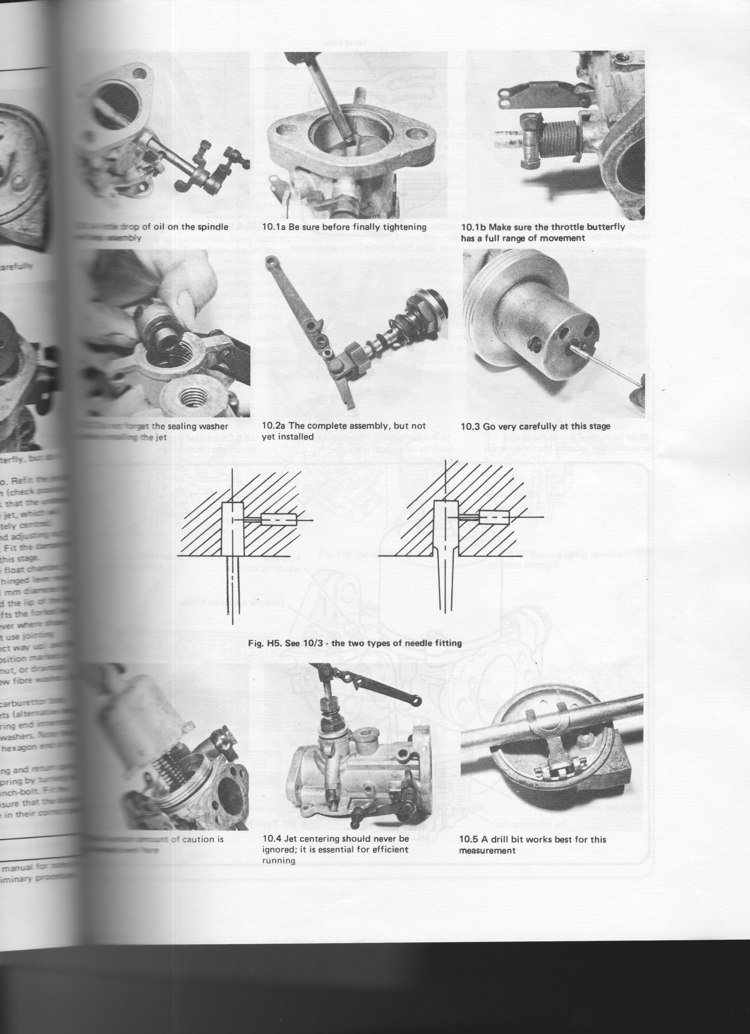

What I'd do: Spray them with your favorite penetrating oil--I favor Kroil (note: WD40 is not a penetrating oil)--repeatedly for a day or so (squirting into the screw hole should be especially effective). You might try a little heat, say, with a heat gun on 'low,' but don't overdo it. They do get plenty warm when running, but too much heat might distort the aluminium.
I'm curious about how the needles are set in either set of carbs. This scan shows two types, but all the ones I've seen had a full groove and not just a taper; it can make a surprisingly (to me) significant difference in mixture strength. I've run STD needles in my BJ8 through decades of California gas insults with no issues.
