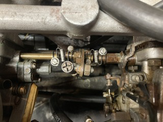

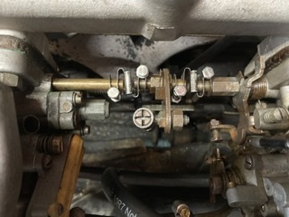

-Upon reassembly I cannot get the connector lever to run parallel with the carb shafts (see photo) and the car needed almost full choke to run.
-I adjusted the connector link slot with 3/32” drill bit. That has put the threaded rod/connector link almost over the shafts instead of to the side as before. The car know needs just a little choke to run.
-it seems to me that having the linkage cockeyed can’t be good. I’m not very proficient at carb work so please be clear (idiot proof) when describing carb parts and procedures. Thanks for any help.

NutmegCT

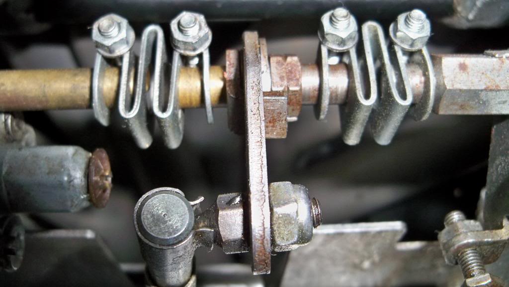

Difficult to see in that photo, but I think one or both of the S-curve "springs" on either end of the connector shaft are bent and/or stretched out of shape.

ringo1
They looked unchanged from removal to reinstall, but perhaps I bent them on install. I’ll pull them off again and see how they look now.

poolboy
The throttle shafts don't look like they line up.....maybe it's just the picture, but if the throttle shaft are not lining up, you need to find out why,

ringo1
One of the “s” springs was a little out of whack. I got it straightened out and the connector to carb throttle shafts alignment is much better.
I shortened the connector rod between throttle assembly and the carb shafts and adjusted almost all gap out from the connector lever (between the “s” springs).

Gliderman8
Do you have the same insulator blocks in each carb?
From your pic the insulator block on the right carb (in pic) looks like a different thickness from the one on the left. If they are different that would cause the shafts to be out of alignment.
I did notice that and they are slightly different even though they were new when carbs were rebuilt. I loosened one without creating a vacuum leak and tighten the other. That brought them closer to parallel.

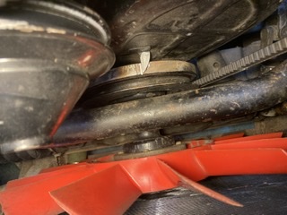

-And the real head scratcher, used the timing light and can’t see my white TDC mark. Turns out it’s about 3”-4” below the pointer clockwise facing front of engine???

-It still leaves me concerned with why my timing light is showing my timing about 90 degrees from BTDC.

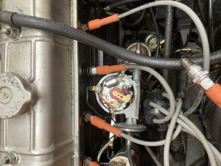

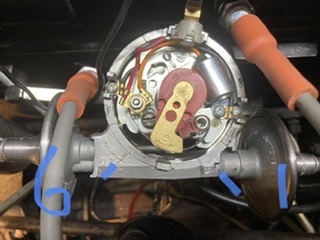

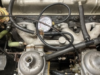

I recommend that you post a picture of your distributor with the cap off so we can see how it is setting in the car, and which direction the rotar is facing. Also post a picture showing where you have the vacuum gauge connected to the "intake".
Bob
R
ringo1
The attached photos are my timing marker, the distributer and the vacuum gauge hook up. All with car at TDC of compression stroke
