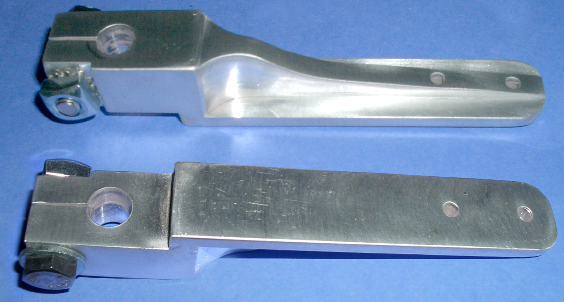

GregW
vette
Greg did a beautiful job. I have an easy solution. Eliminate the OD throttle switch. Just remember when you take it out of OD to either have a little acceleration or use the clutch. Either method eliminates the hard bump to the driveline upon releasing the OD. At this point in my life, I always use the clutch when shifting in or out of OD. It's just like driving a 5 speed.
