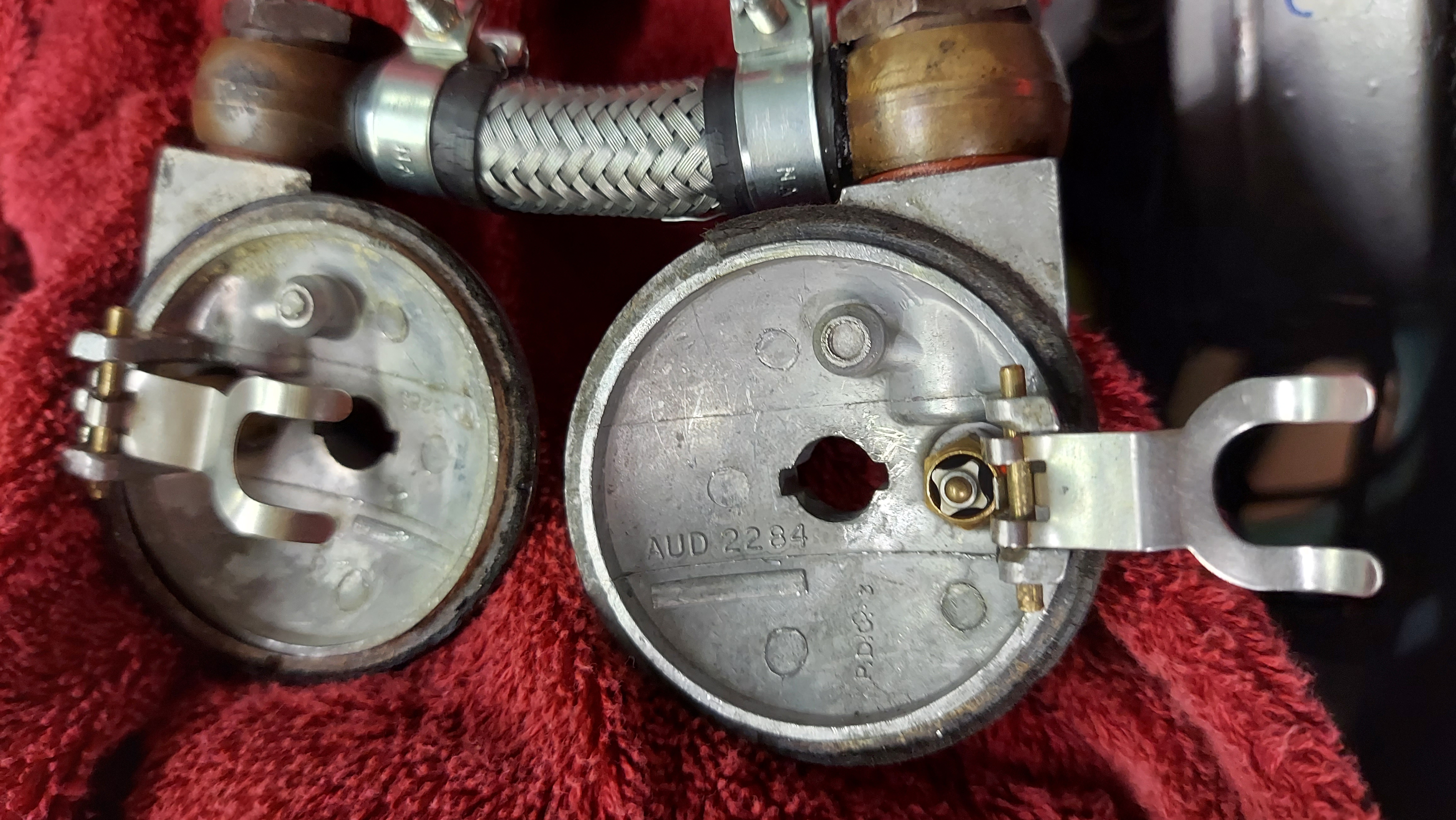

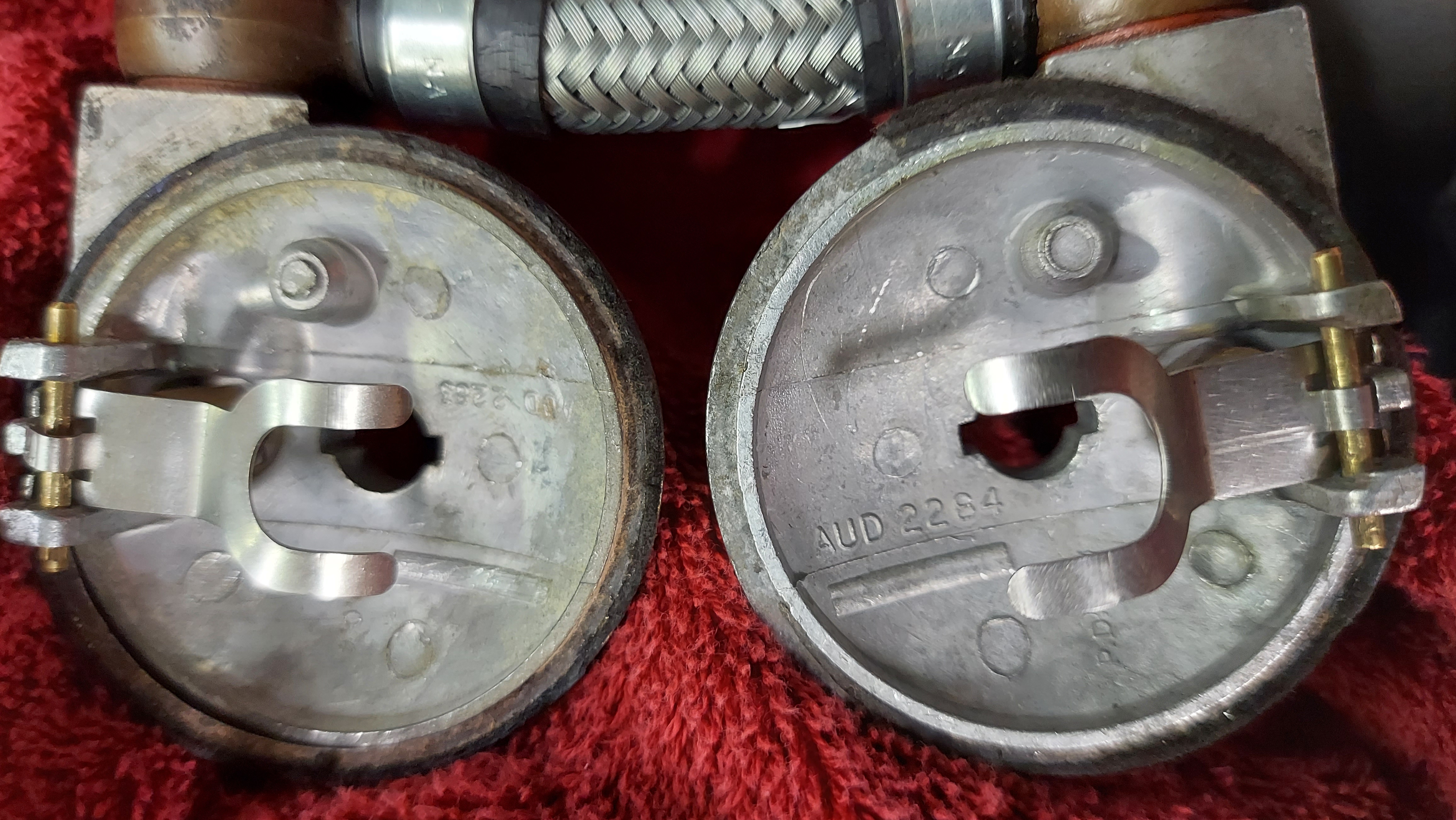

Guys... I was trying to diagnose a starting problem on my BJ8 and noticed a lot of flooding occurring out of the float bowls. I have never had these apart, but noticed the 3 prongs on the float levers attaching end were bent up and one of the levers was even installed upside down! I don't think they are the original float levers. My question is, should these be attached to allow the lever to move full motion? If it did, it would seem like the needles would be free to fall out when fully open.
The other option is to allow only limited movement of the lever by extending the middle prong so it stops on the small metal bar in the middle. It's a wonder these things worked in my car at all!
The manuals depict only the original levers configuration. Any help appreciated!

It's been a while since I've had my BJ8's carb float lids off, but to the best of my recollection yours are installed correctly. Yes, when held correct side up, the levers will hang just prior to the angle at which the needles will drop out, about 45deg from horizontal (the center tang should prevent that; i.e. you should not be able to 'flip' the lever completely, as in the bottom lid in the first photo). The part of the lever that contacts the needles should be flat, adjustments should be made at the bends on either side of the flat part, mostly at the 'hinge' side. Your levers look correct, but someone has ham-fisted them, probably to get the correct nominal setting--5/16" or 7/16", I can never remember without checking the manual and I think it varies with carb model--without knowing or caring why or how this should be done. Yours are probably salvageable if you work them carefully with needle-nose pliers, but if any doubt buy new ones. Car will run OK as long as float level is correct, but yours could risk jamming the needles in the valve.

Thank you Bob and Big Green both very helpful! Interesting, that before I took the photos I flipped one of the levers back to the correct way. Before, it was fork tines down and this was causing that float bowl to fill about an inch lower than the other one. I'm wondering what effect,if any,it would have on performance,starting, etc? The car actually seem to run OK albeit hard starting sometimes!
