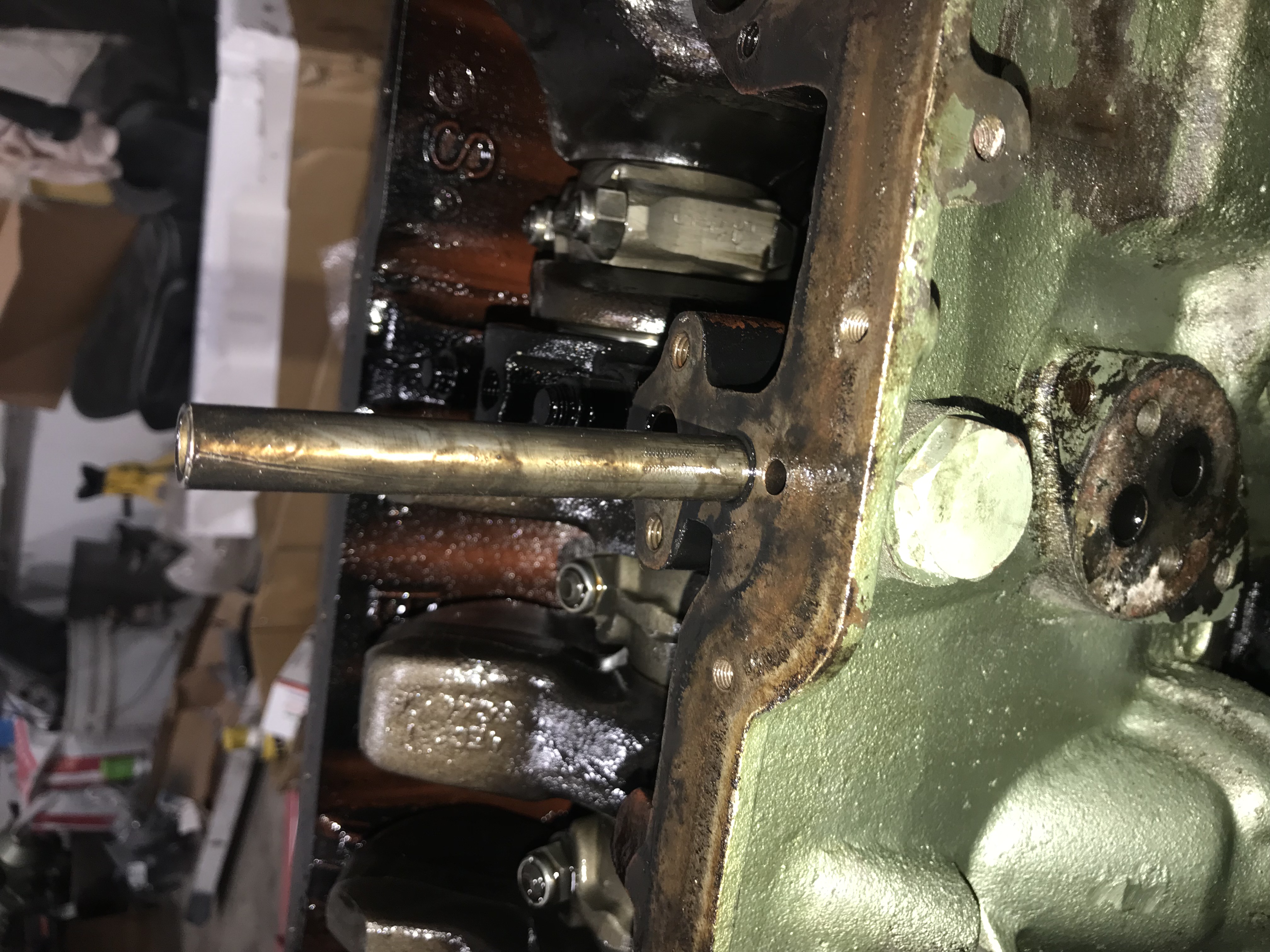

I am tearing down a '67 BJ8 motor. There is a tube below the oil pressure relief that I can't identify in the service manual or other online diagrams. Is this a valve drain pipe I've seen mentioned in some posts? Is it pressed in or threaded in?

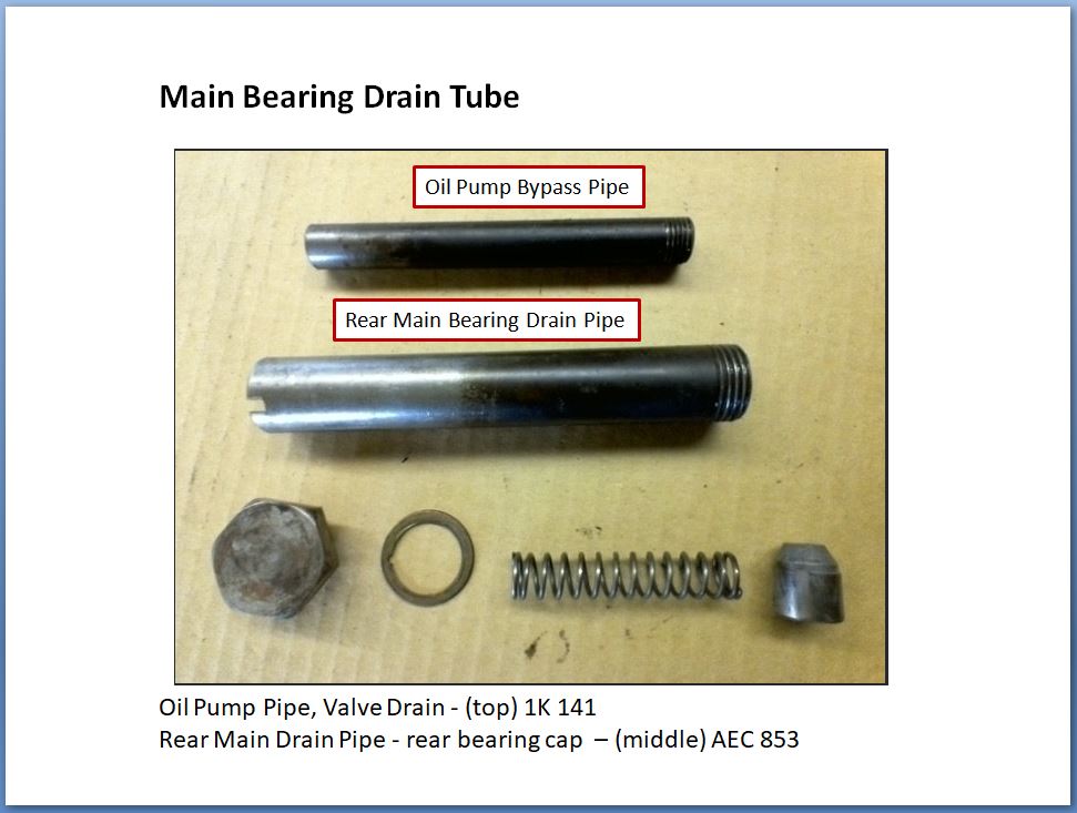

Yes, the Oil Pump Bypass Tube/Pipe drains excess oil from the pressure release valve.
And, you can see in both of the slides, it is threaded.
Regards, Bill

Bill, thank you so much - exactly what I needed, they are now removed, bagged and tagged :smile:

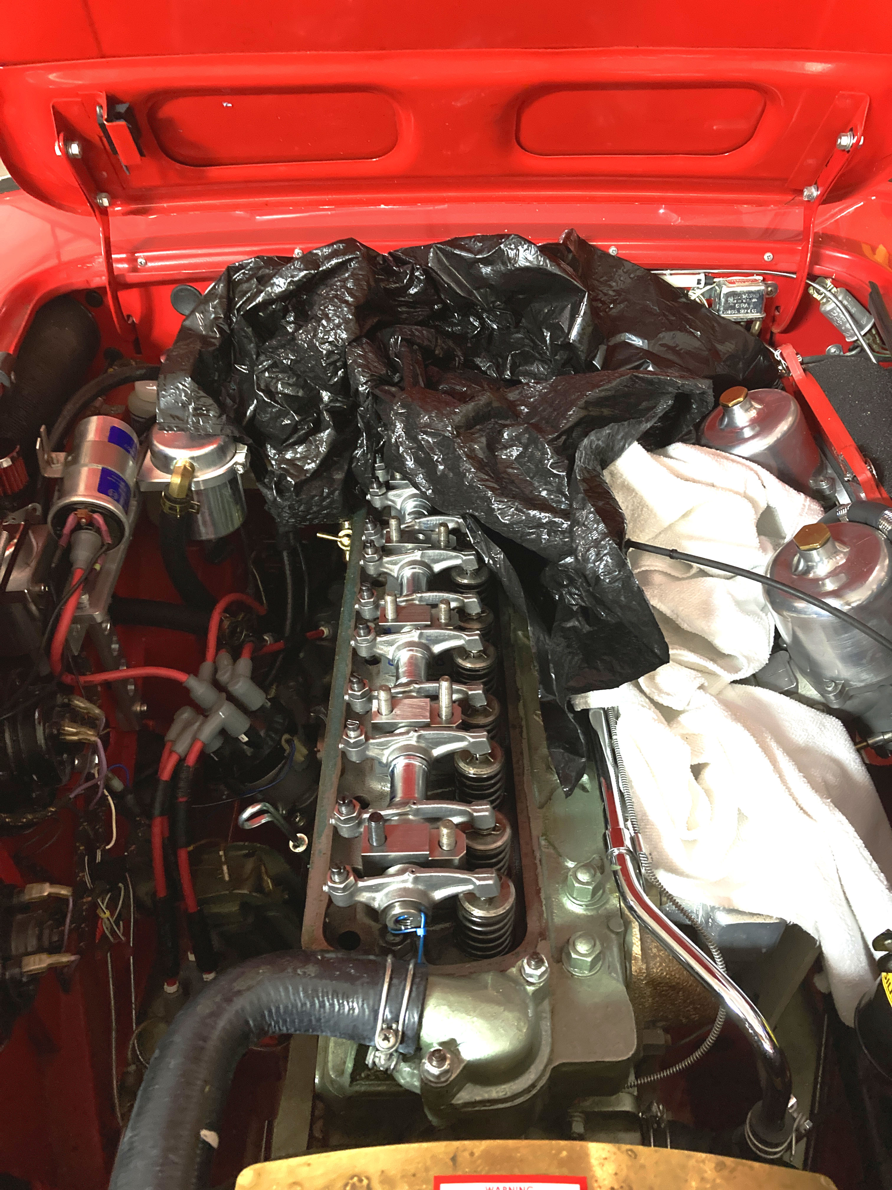

In the meantime, will make a few changes this spring before the best driving season starts. I was doing a tuneup a few weeks ago and noticed one of the rocker arm spacer springs was starting to cut into the rocker shaft. And, decided to rebuild the assembly using the Denis Welch rocker arm spacers and hardened shaft. Waiting on a few shims now to center the rocker arms with a slight offset and adjust spacer clearances.
I really like the rocker arm spacers; there is virtually no friction and everything can be positioned correctly.

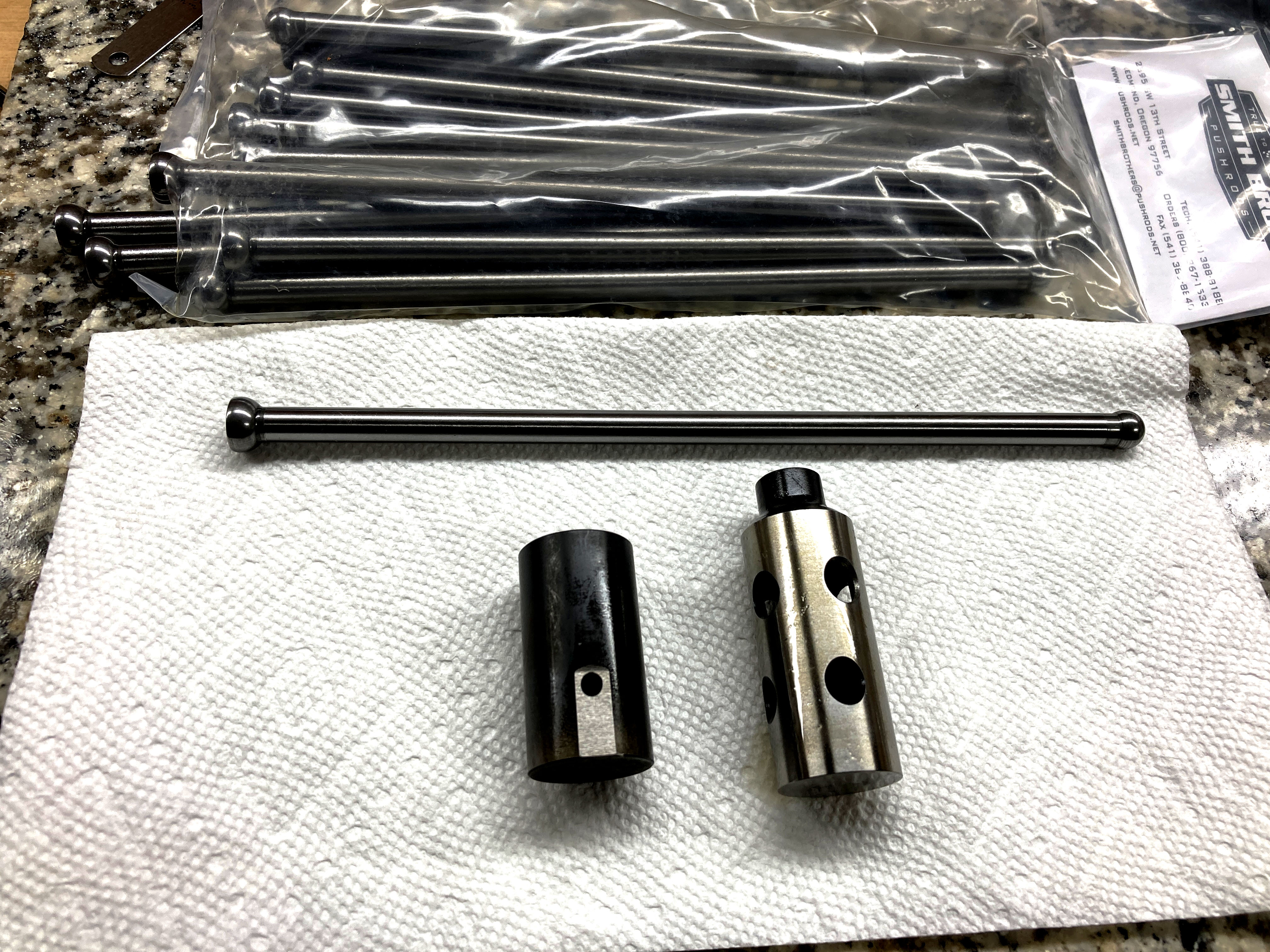

Of course, thought this was a good time to check the cam followers and cam lobes. :( Two of the followers had one very small pit and I am changing them too before any damage is done. The cam is still in great shape with full lobe lift at every valve location (0.261-inches). The latest lifters have good hardening, but the machining was off as sold (crowning and diameter).
Rocker Arms Unlimited did the rocker arm rebuild, checked over and crowned new lifters and also checked their hardness. Will use Smith Brothers pushrods (with new adjusters) so everything north of the cam is in like new condition.
I'll decide on the cam to be used in the full rebuild later based on recommendations like yours, but will keep it close to BJ8 specifications. I have a set of MGC cam followers with good hardness and crowning; and Smith Brothers are making the required lifters for those too. Might use them in the full rebuild. They are used more in racing as you know, but some builders say they are not as durable long term on the street.
Regards, Bill
