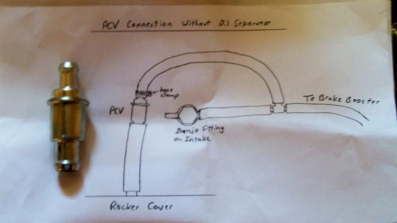

As long as the seal is good the cap isn't supposed to vent. I wouldn't be surprised if it did leak a bit though.
I have but never installed the Good Parts PCV kit. I think I must have bought it for the other engine that was in this car.
https://www.goodparts.com/product/pcv-kit/
This is the sketch RG provided for it's installation.
vette
Hello Steve & Poolboy, I really don't like that arrangement in the drawing. What I don't like is that the PCV is plumbed into the vac line to the brake booster. Even though the vac should be drawing everything to the manifold as we all experience oil goes everywhere. I can see over time that the oil would migrate to the brake booster. A brake booster vac line is a clean line its routing being from the intake stream to the booster. This provides the brake booster with maximum vacuum available and there is nothing else there to contaminate it. In providing a connection as in the drawing you are doing two things not normally present in a brake booster line or a PCV system. Firstly you are exposing the booster to possible contamination and secondly you are possibly reducing the amount of vacuum to the booster. That is because the given amount of vacuum available from the engine is now spread out through out the crankcase with its associated leaks. The vacuum will be compromised reducing its ability to operate the booster efficiently.

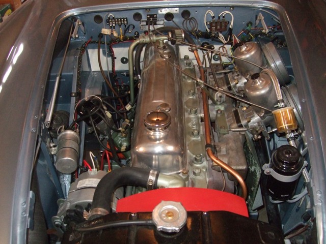

So that leads me to my solution. My solution is based on the premise that any environmental benifit from putting a PCV system on a vintage engine is so negligible that the benefit is inconsequential and a waist of time. There aren't that many vintage engines running around and their use is minimal. So my solution is to do truely what the term means, that is ventilate. Make it like the early engines were, vented to the atmosphere. Either a downpipe or a filter on the end of the crankcase opening. Attached is a picture of my Healey vent for the crankcase. This has the added benefit that the fumes no longer choke up the rear carb which is where the hose originally went. The rear carb is as clean as the front one. That K&N filter doesn't even weep oil and believe it or not my rear main seal doesn't wet the floor. So the answer is Just Vent it, Don't Plumb it.

The Good Parts drawing is functionally the same as this:

You do not want a vented cap to be used with a PCV system, it will draw a ton of air and over lean the mixture, not to mention burn excessive oil.
