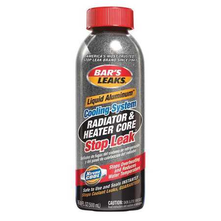

As a quick temporary fix and has been on the market for many years and has proven successful in many cases. Bars Leak.
