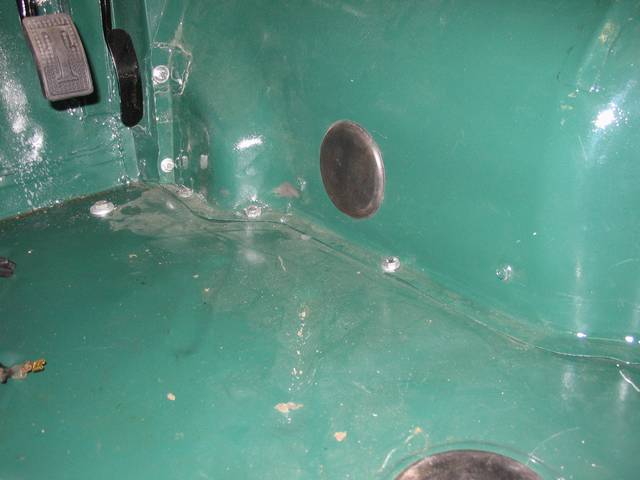

On the green TR3A I finished last year, I cut a large hole in the tunnel beside the gearbox fill hole and close it under the carpet with a rubber plug that is also used for the jack hole in the floors.
