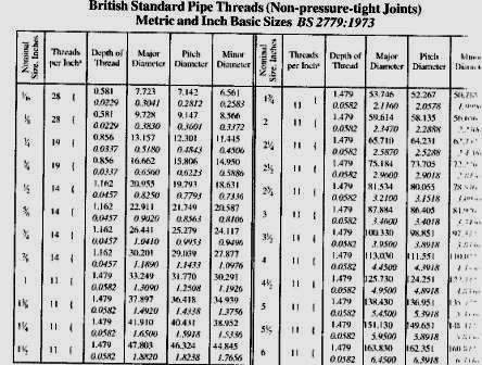

Tinkerman said:
I have an original brass petcock(with a very loose spring). the threads are very definatly 18 TPI and it is a very loose 9/16 in diameter. Tinkerman
That sounds like 1/4" BSP.
19 TPI, major diameter .518"
Jeff

Tinkerman
Yep, your probably right. I finally found the drain plug hole and the petcock I have, doesn't come close to fitting it! I had been looking in all the wrong places, heh. So I guess I bought an eBay wrong part! Thank goodness I didn't cough up to much for it. Might fit the radiator but thats all put up so I'm not going to worry about it right now.
