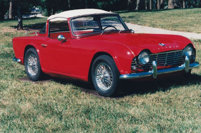

I agree , bronze is for racing and must NOT be too tight. This will make you burn more oil. The best result on a fresh head
was new guides knurled to fit the old valves.This head did not burn oil at all .Drove 5500 miles on a big road trip in 2000,
consumed 3 qts total on the trip.Had one flat tire and the tach cable failed. Not bad for a 63 tr4.Packed a but load of spares
and never needed one!
