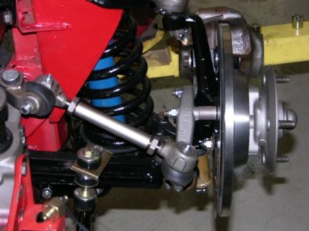

Stig
Does this help? I have more pix.

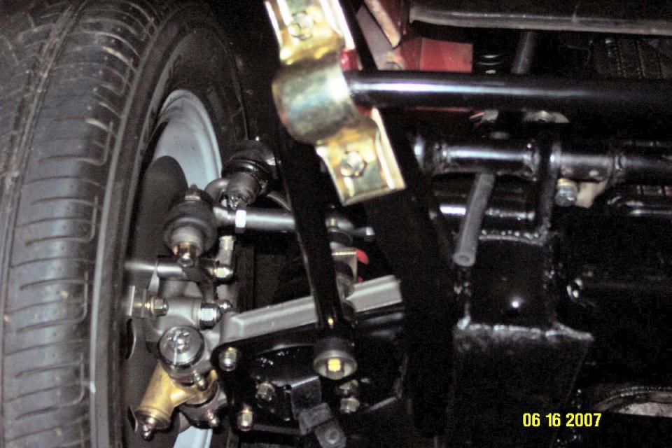

PeterK
A little fuzzy but shows that the attachment to the frame extension/bumper brackets occurs at the apex.
