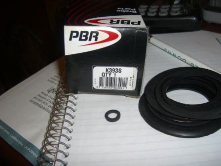

I bought these kits at the local store a couple of years ago, they are Australian.
