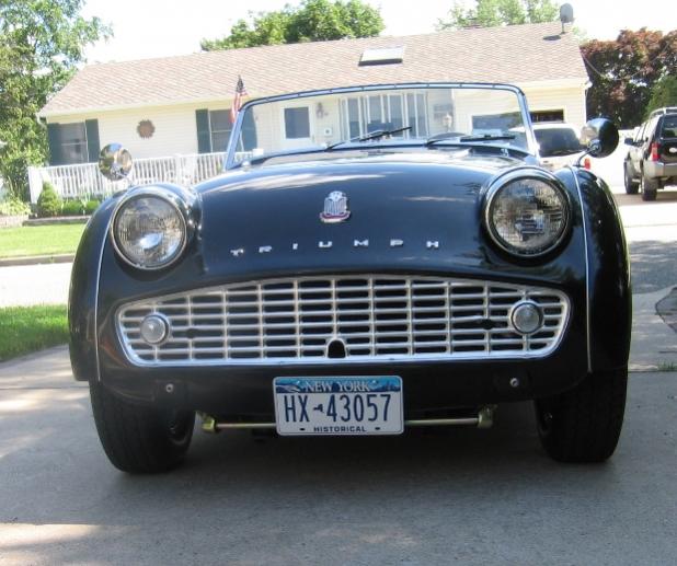

We don't need no stinkin' bumpers... :driving:
