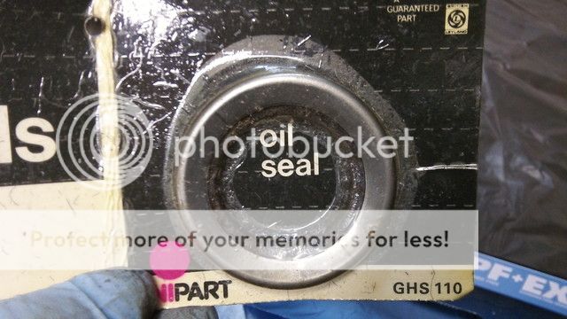

I did the search and read several different threads on the installation of the hub oil seals...
I did find a few threads on this forum and others that contradicted what I thought was the correct installation so I thought I would confirm it here....

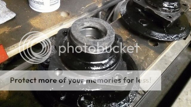

Here is a picture of how I think the seal is installed in the hub....felt towards the verticle link.
I did read the info on felt thickness etc with the new felts needing to be trimmed to fit.
I found a couple of old seals in my parts bins that I am hoping are close to the proper thickness....
Thanks as always.
Cheers
Tush

Felt towards the link is correct.
Easy way to deal with felt too thick is to do a trial installation without it. Find the bearing adjustment (remove all play, back off 1/2 flat), mark the nut. Remove the hub, pack the bearings, install with felt, return nut to marked location.
This is actually written up in one of the factory manuals, but I forget which one offhand.

Thanks for the confirmation. It is appreciated.
