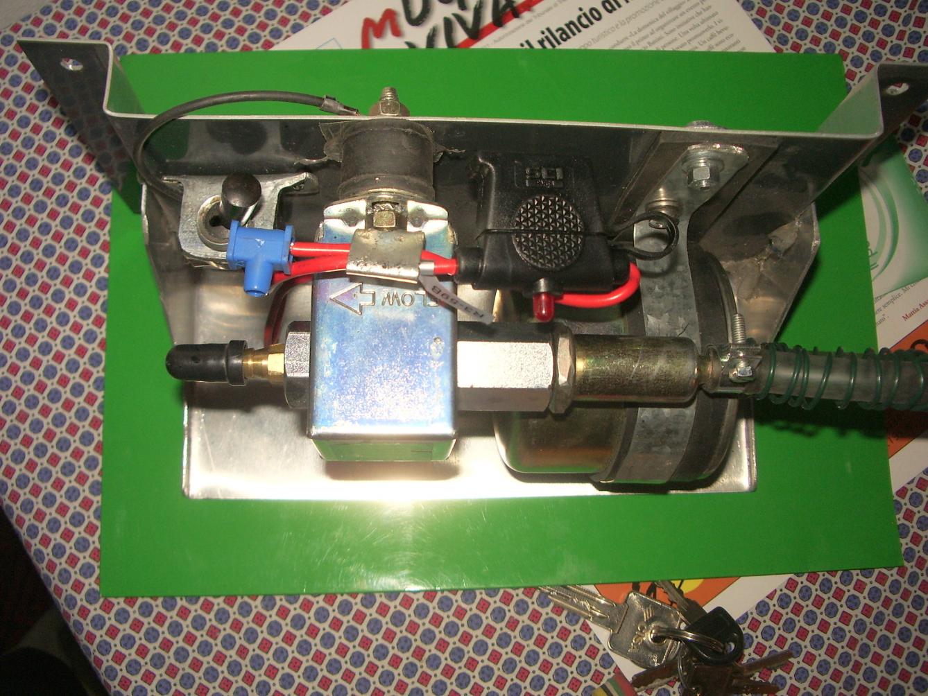

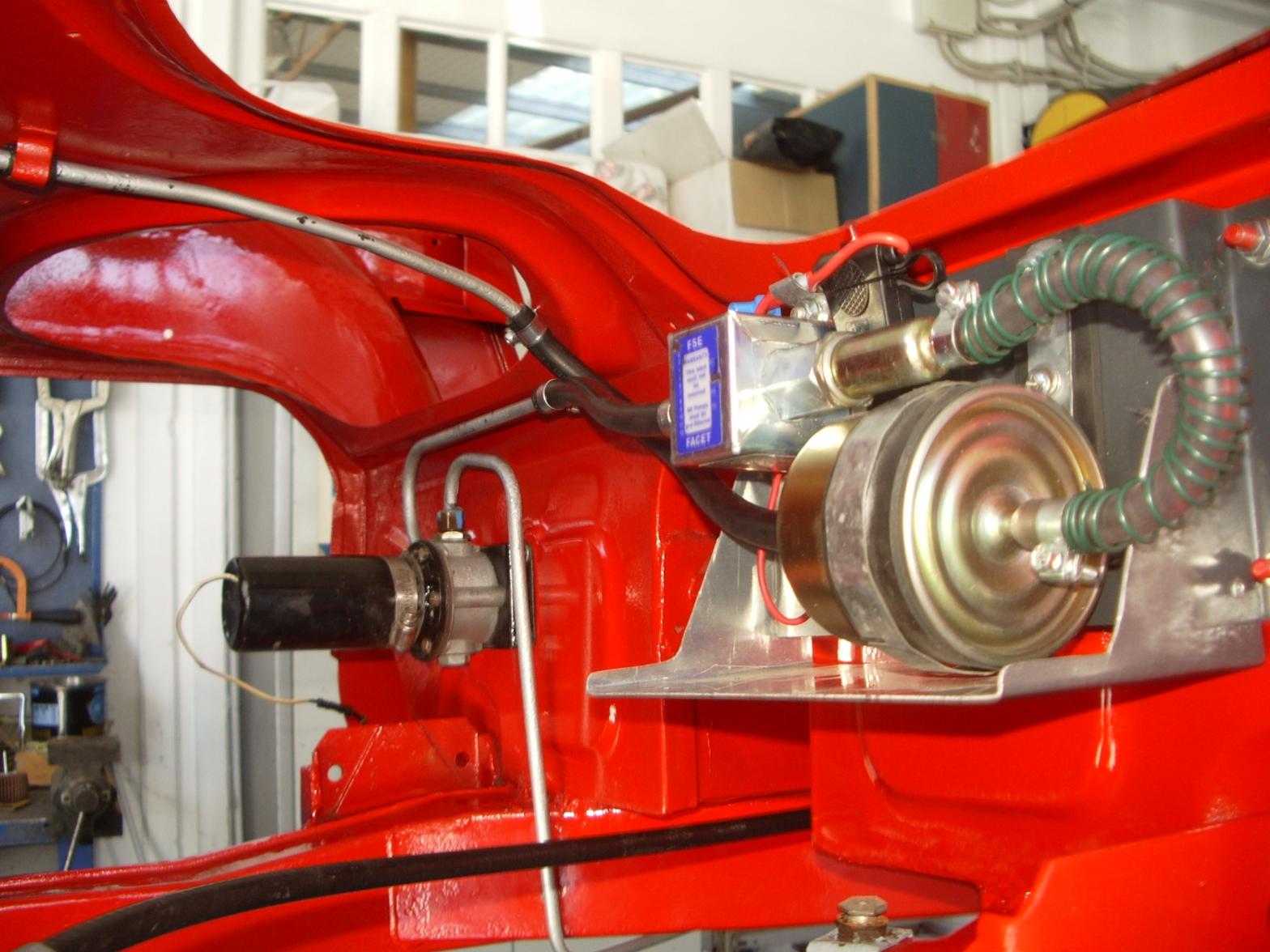

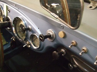

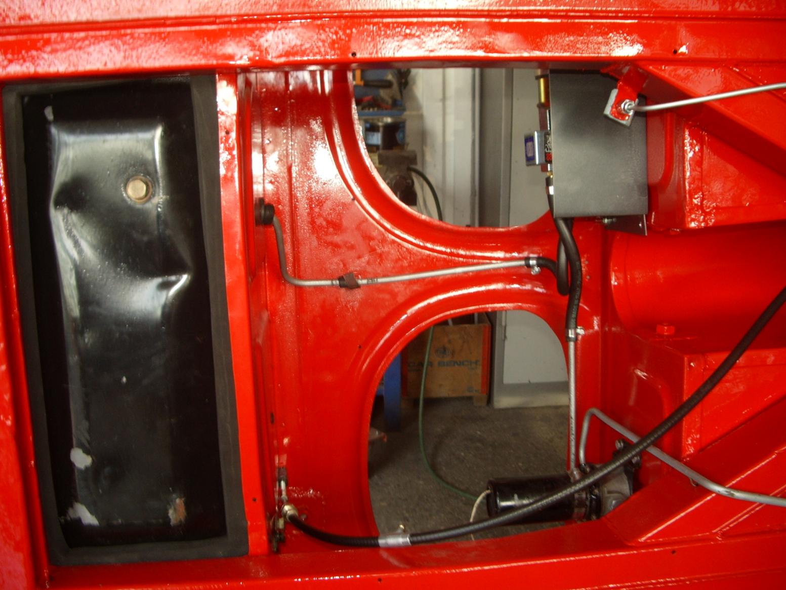

I have fitted a FACET square pump in series to the original SU IMGP0759a.jpgIMGP0975.jpgIMGP0980.jpgin the other side of differential home, with a switch -SU ON- OFF -FACET ON-i have added a fuse and a BIG fuel filter to assure clean fuel to system-

andrea
Hi Steve

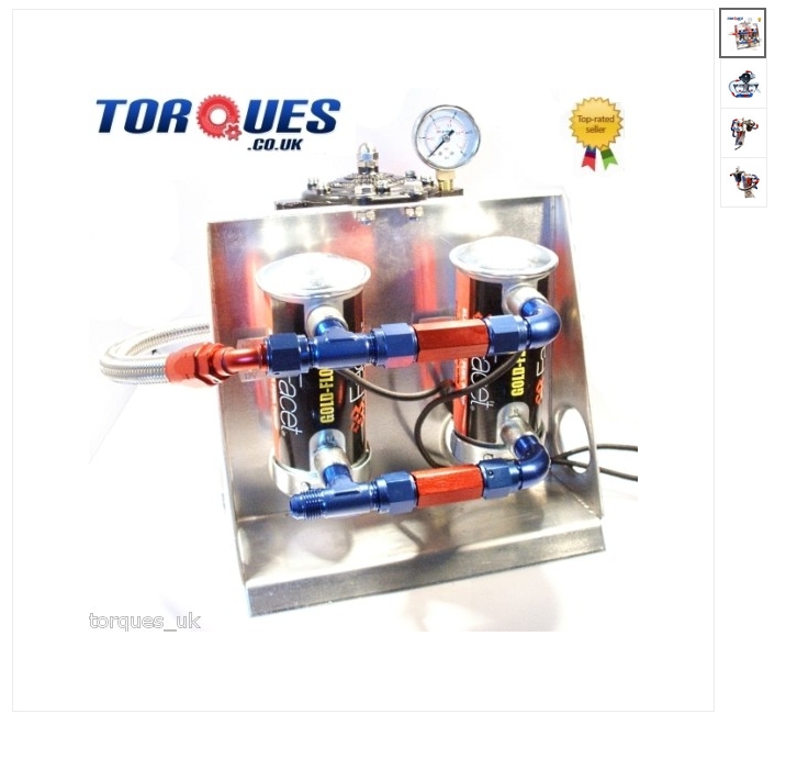

I have build my self the pump box, with a scrape plate of aluminium powder painted,FP1.jpgFP5 GBP42.jpg
that I have find in my cavernous laboratory, (easy riveted)
I was inspired by this photo of a prof(and expensive)rally installation,
my intention in the winter is to change the rubber pipes, with inox braided pipes- and prof.connection acquired from Torques UK -NCI
Cheers

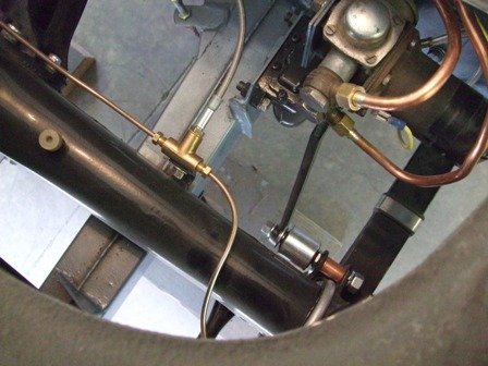

I don't have a pic at the moment of both pumps, but here is a pic of the right side pump looking down thru the rear seat openning. The one on the left side is exactly the same and mounted on a bracket I made which is a copy of this original mount but in reverse. I plumbed it all in copper and the left side pump is moved inboard as close to the pumpkin as I dare to get it from being over the exhaust pipes. The left side pump feeds thru the right side pump. I wired them with two toggle switches with normally open and normally closed contacts so that I could make an electrical interlock so both pumps can't be turned on at the same time. Dave
