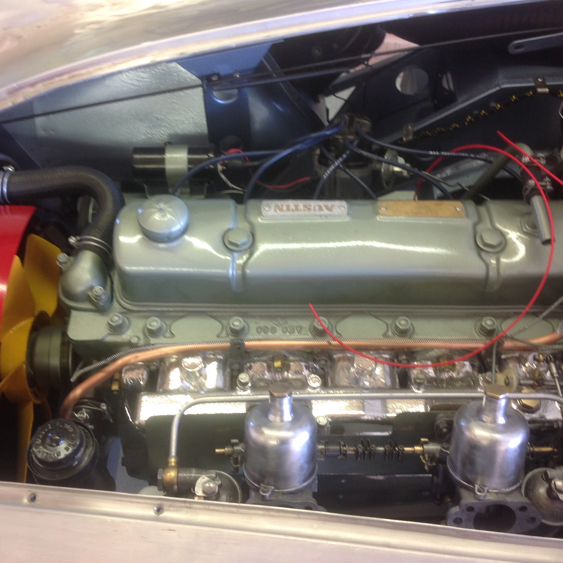

Rob Glasgow
I used the Hirsch paint on my car. It matched the original color more closely than the Moss version. It’s more blue/green than the Moss yellow/green. I bought the quart can and it was more than enough to do the engine and transmission.
