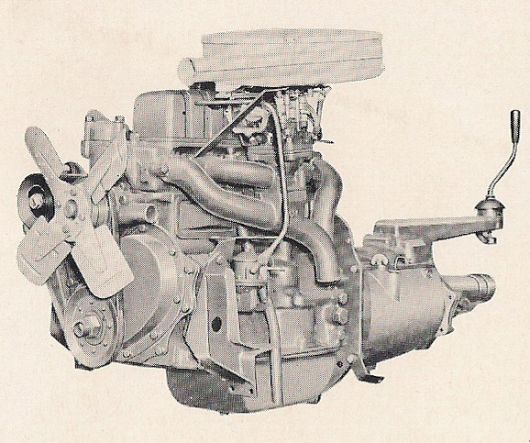

Early Bluebird, as I recall. I have a picture of the engine around somewhere. No mistaking it as the same as the BMC engine.
"In July 1960, a five-door station wagon was added (WP310). The P310 was powered by the 1.2L Nissan E engine"
"The first E-series of engines was one of Nissan's earliest homegrown designs. It did not use the same nomenclature of the later Nissan engines, with all models sharing the same displacement and simply called "E". It displaced 1.2 L (1,189 cc) from a 73 mm (2.9 in) bore and 71 mm (2.8 in) stroke. Output is 48 hp (36 kW). This E series was produced from 1958 through the late 1960s.The first version produced 48 hp (35.8 kW) and 60.7 lb·ft (82.3 Nm) from a single carburetor. A later E-1 version added dual carbs and better cam timing for 60 hp (44.7 kW) and 67.3 lb·ft (91.2 Nm)."
https://en.wikipedia.org/wiki/Nissan_E_engine
Gerard
The 1600/Fairlady. On edit: Bluebird? It's this thing:

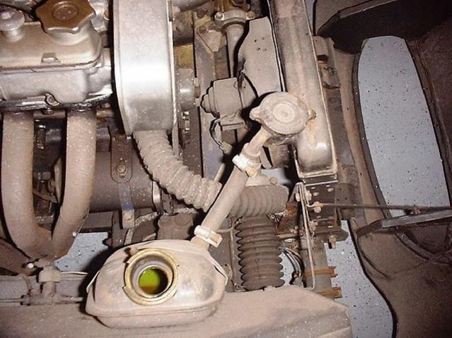

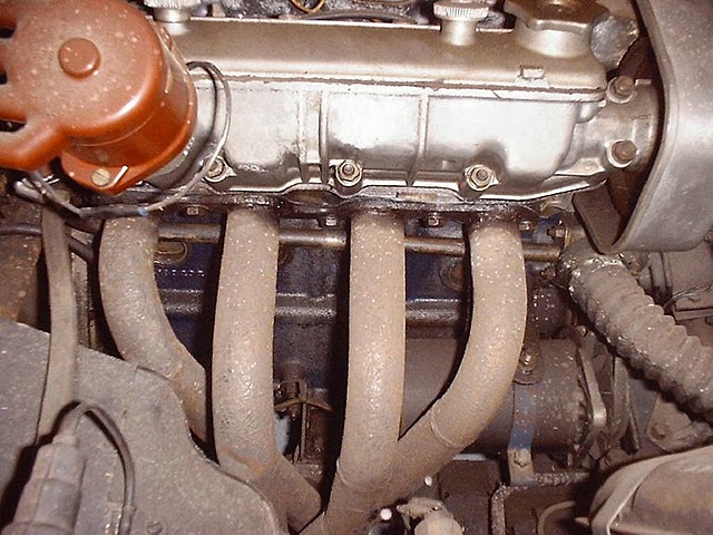

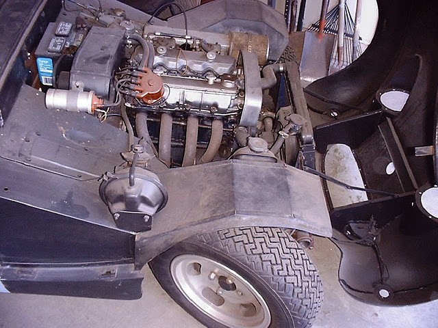

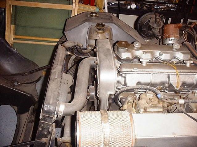

Rick B, Mike, and myself have cars running the A 15 1500cc datsun engine and five speed trans. This is about the easiest swap other than the 1275 and ribcase. I like the swap and have procured parts for more. Having said that I would caution anyone considering it that Nissan has NO support for these older engines. At least where I am I can't find a Nissan parts person that can get me anything.
The front steering rack tube is the only body mod I have made. The engine require's a reworked oil pan, home built exhaust, and finding rare sidedraft intake or making one as I have done. Trans can be mounted with Gerard's or other's aftermarket kits. Engine mounts need to be fabricated.
Power is only a guess but figure at least 80hp. I have no trouble cruising all day at 80mph plus if necessary.
The 4AGE toy swap has been done and the suzuki DOC engine as well [bugzuki]. Not many engine's that fit and finding rear drive transmission's is getting to be a problem. If you think about it the only rear drive stuff out there now are high horse power or pickup's.
The 4AGE hooks up to the t50 toy trans but the bell housing is almost impossible to find. Then you are looking at making the fuel injection work and better have the brain box and know how to hook it up. Spectacular engine if you can make it work and keep from snapping axle's!
BMC really makes the most sense even if a bit stressed on free way's.
