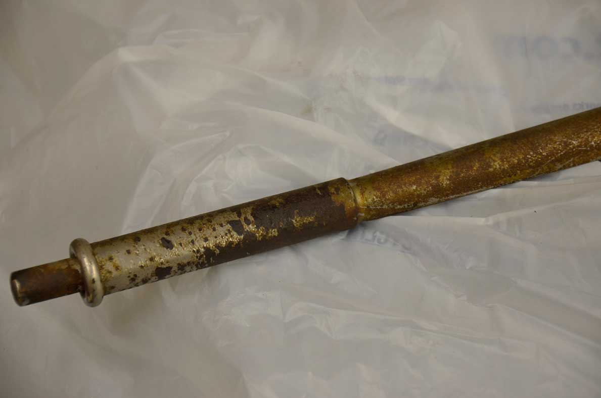

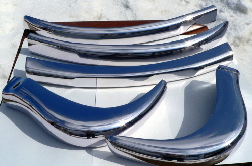

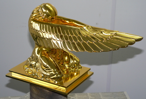

Just discovered this website today - https://coatofchrome.com/home.php. Looks intriguing. You have to send him a part for him to quote the job. The good part of this process is that it can be done on any material, which means that he can fill pits with plastic filler and sand smooth, then coat it. I'm going to send him a small part to see how it works out. I'll report back in a few weeks when I get the part back. Check out some of his stuff.

He must be pretty good if they're letting him plate the Ark. :laugh:

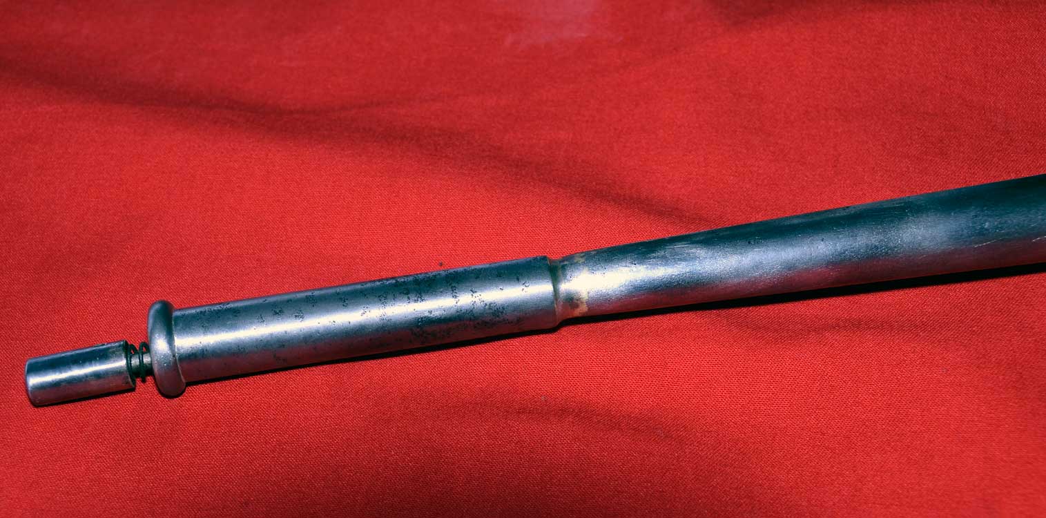

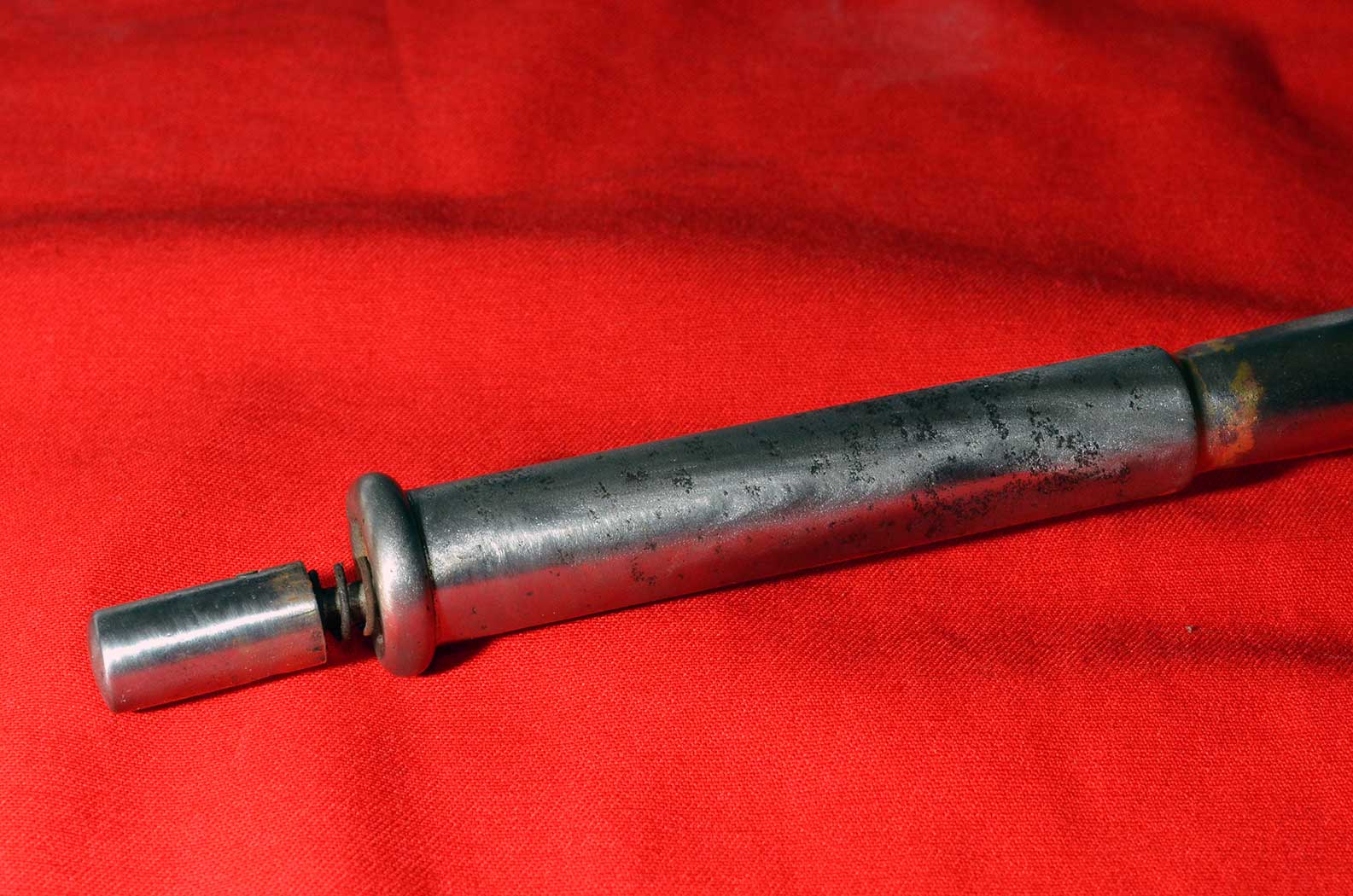

I'm going to send him the parking brake handle. That should be a good test.

Remember, that paint is not going to stand up like real chrome as far as something like that handle where it can get scratched. That is some serious corrosion. There have got to be people on this board that have extras to send you one of those. They are not bad to break down and get like that. I might have already thrown one out.

You must not have seen the first Indiana Jones movie. That thing is off the hook! :jester:

Rep, that is a lot to smooth and fill. I can see it for a test for more expensive stuff. That brake handle will probably cost two or three times what it's worth when done.
As I said in the original post, this is an experiment to see how good this process is and what the price is compared to re-chroming. What better part to send than one like this that has many faults and will be subject to some wear and tear? I know I can get another one, but that isn't the point. The corrosion is just from where the original plating has worn off. I have already cleaned that up. The pitting that has been left, will be filled with ordinary body filler and sanded by the person doing the process as opposed to cleaning, braze filling and grinding smooth each pit by the chrome plater. That's where the real cost in plating comes about. That and the cost of having to legally dispose of the chemicals. Granted that it may not be suitable for all applications, but if we can find an alternative to chrome plating that will hold up decently and be less expensive, it will be a good thing.
