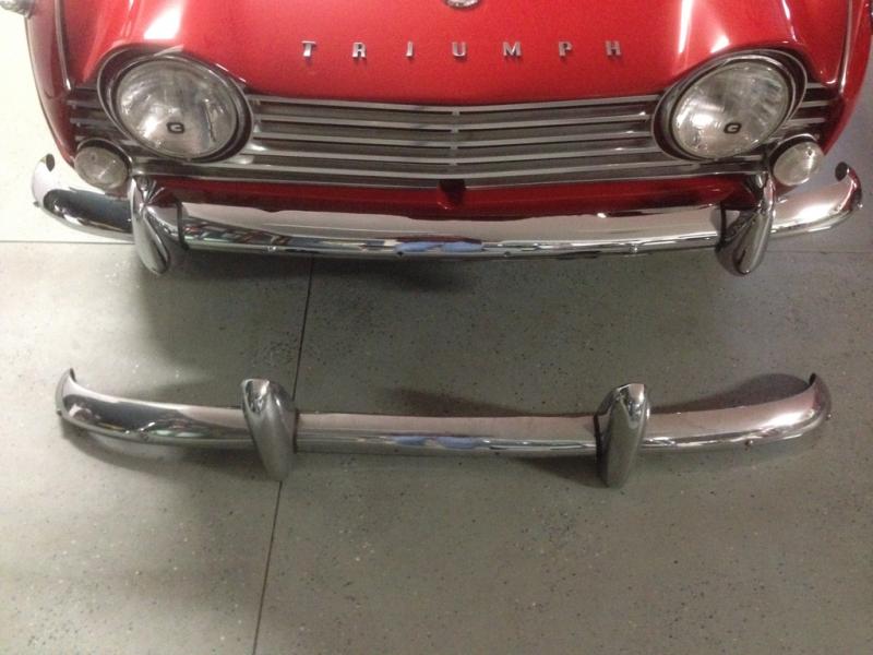

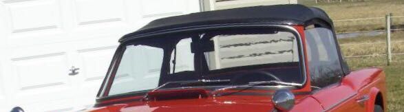

Some things on your 4A don't match...you've got a TR4 bumper, the grille has the look of one from a TR250 (TR5), and the passenger side wiper arm doesn't have the dogleg needed to clear the cowl vent when open. When I got mine, it too was a mixture of someone's imagination.

@ 3798J I' am aware this is the incorrect grille. I was thinking about selling this one and source for the TR 4 a grille. Another idea is to make the car bumper less and I will have a look for the correct wiper arm.
