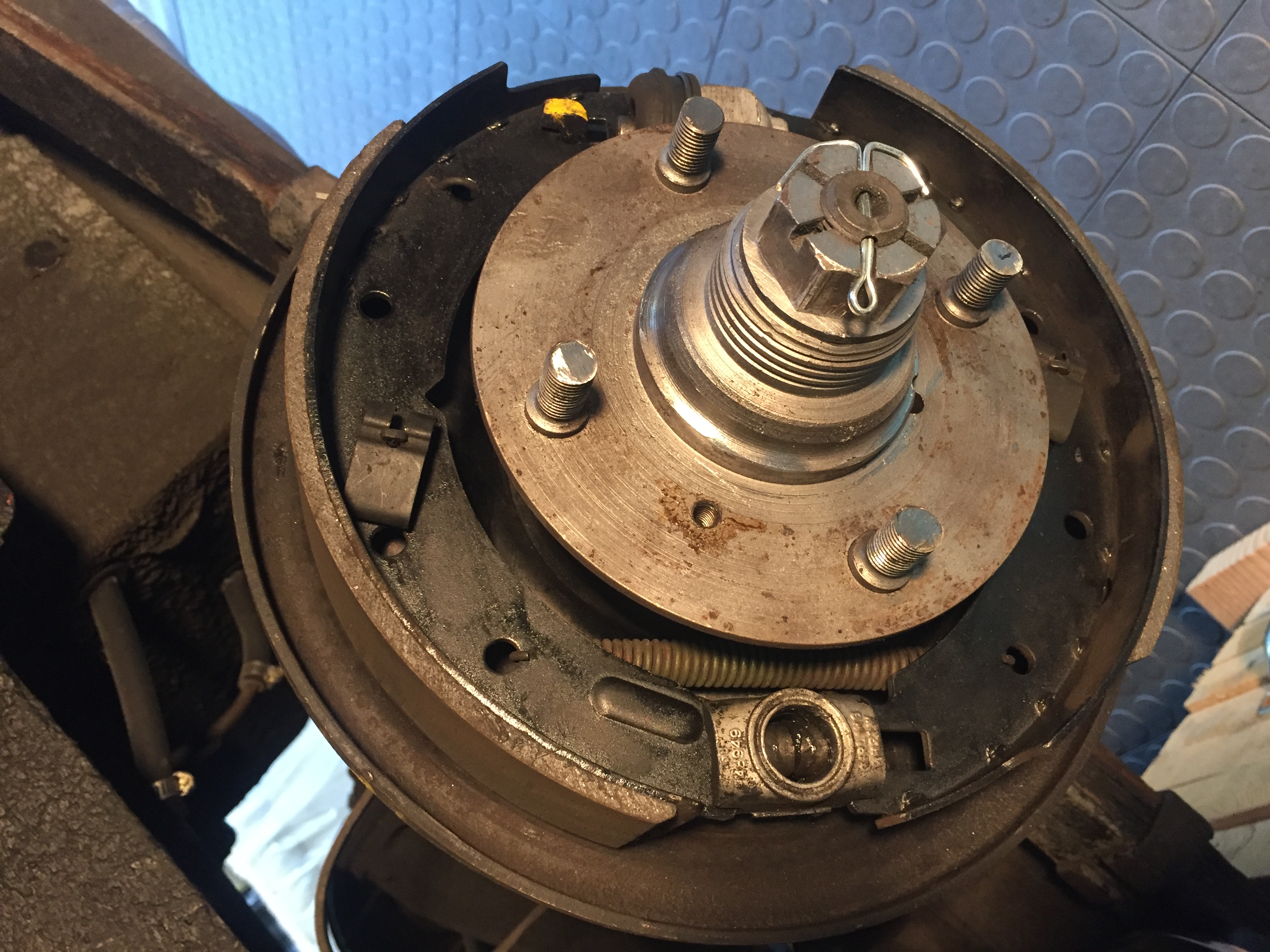

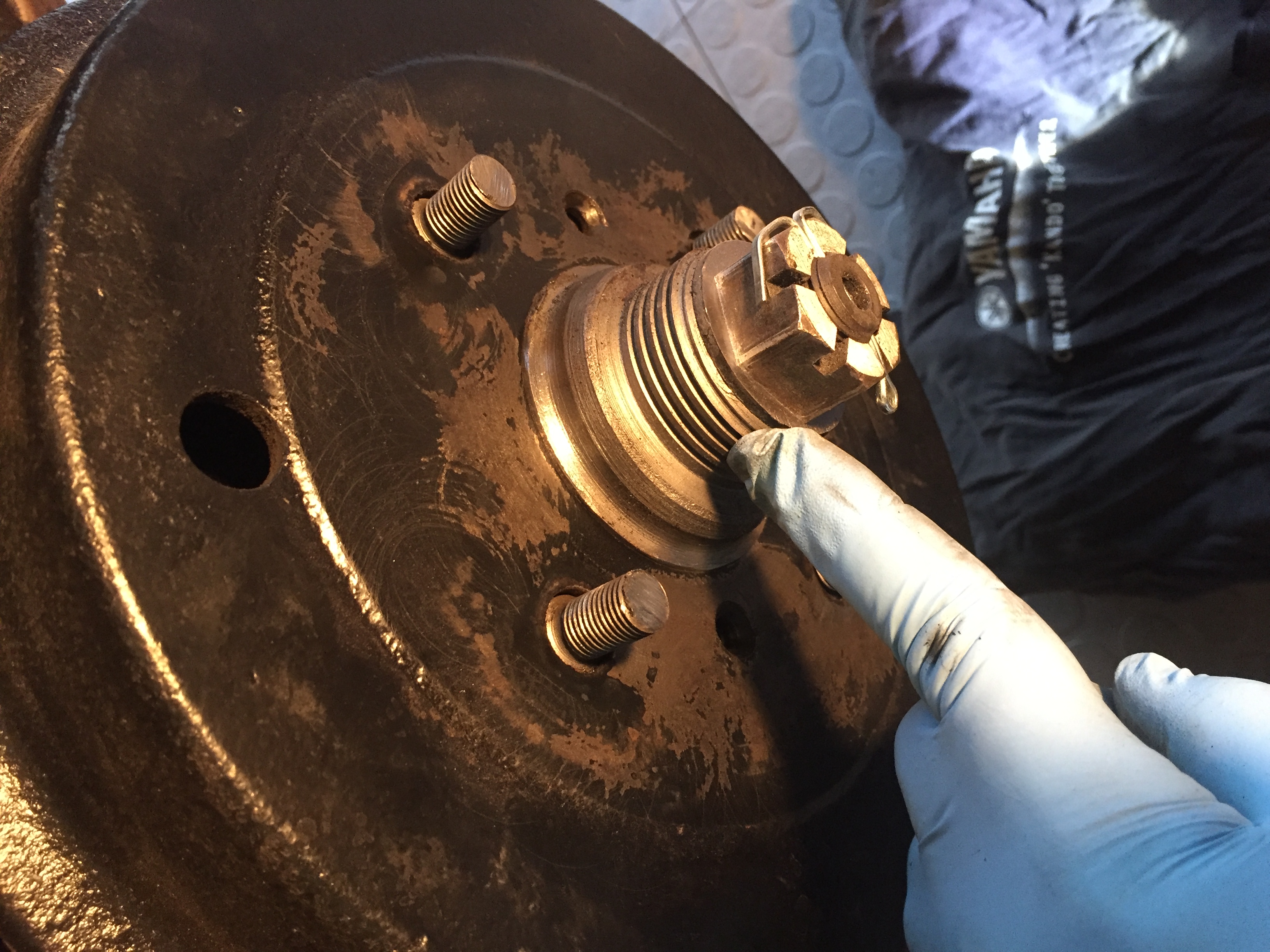

Hi all, just a simple question here - trying to inspect the rear brake shoes and trying to get the drum off for the first time (62 TR4) - I removed four bolts and two screws but it is not coming off even with light tapping. Do I need to remove the castle nut and assembly bit (I am pointing at it in the pic)? Looks like the drum pulls over it but
its not coming off. E brake is off. This is not elaborated on in the manual or in vids on YouTube that i can find. Thanks
Hamish Racing
No you don’t remove that. That’s the axle /half shaft
sound's like you need to undo the brake adjuster on the rear of the back plate..
This will allow the brake shoes to move in away from the drum. it looks clean enough to just pull off.

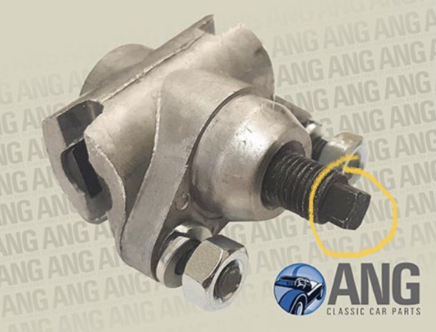

This square adjuster is all that protrudes on the rear of the back plate. Circled in the pic

You have removed all the right fasteners.
Yes release e-brake. Make sure it is releasing: you should be able to move the lever on the inside of the brakes where the cable attaches.
And like Hamish says, undo the adjuster, also on the backside. I generally forget which way to turn these things, but I believe “out” is looser. I turn them one way and see what happens (if tightening the wheel becomes harder to turn.)
If it has been a while since the drums came off, it might take some effort.

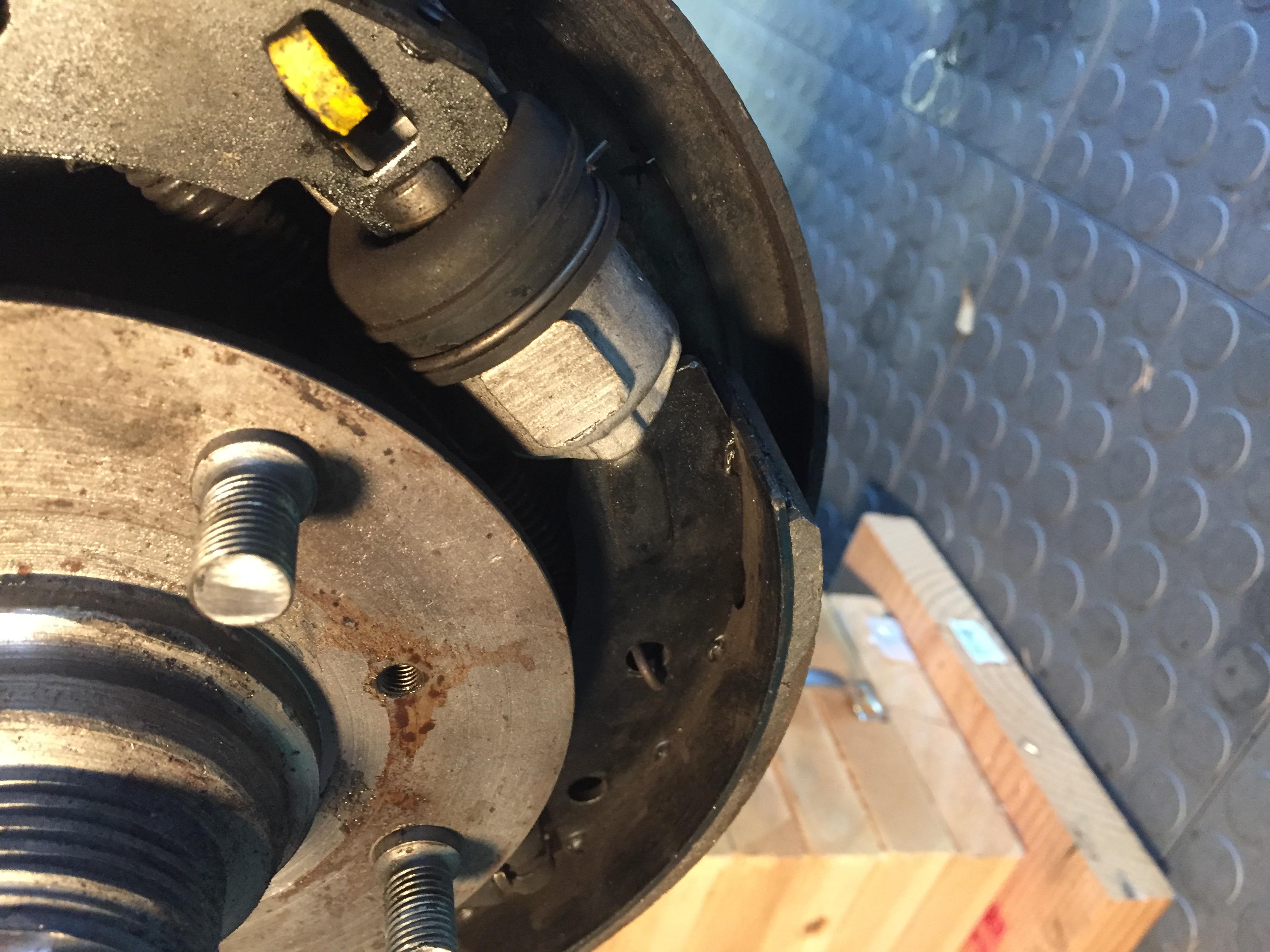

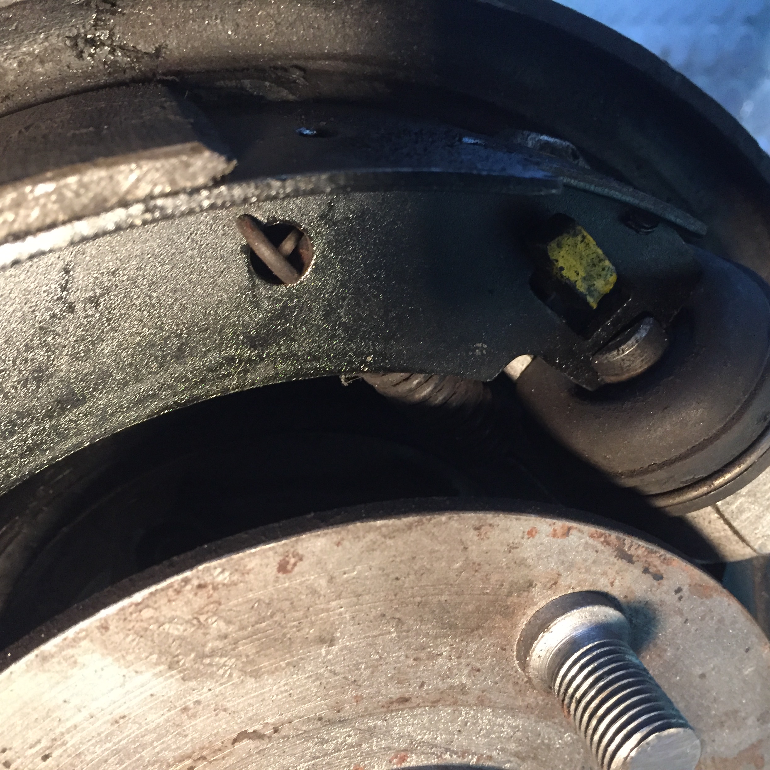

I got the drum off - thanks everyone - few quick questions before I put the drum back on and look at the passenger side (I didnt want to pull the e brake to do the passenger side until the driver side was back together - thanks for that tip sp53!)
I see newer brake shoes with plenty of life from what I can tell. I see absolutely no leakage anywhere in the drum or from the cylinder. The lower spring (the one by the cylinder) has the spring hook backwards but the manual seems to show that as correct. Is there anything you guys see here I should address before putting it back together again? Personally i see nothing wrong here.
Reminder of my issues with the brakes were:
A: I hear squealing when applying the brakes which could just be dirt - should I clean the shoes or anything like that?
B: When I press the pedal it eventually ends up at near the floor - when i let up and press again there is full pressure - does that make sense - like no play. Is that normal or is there an issue do guys think?
Master cylinder is full - not cloudy - no leaking - seems totally fine
Front brakes - pads look newer, calipers look newer, flex lines are fine - absolutely no leaking.
Maybe im just being overly cautious - im not sure if this is how these brakes should feel - this is my first vintage car and only had it for a month or so.

That’s all very clean In The drum. But for future you could buy a clutch / brake cleaner spray. It’s what pro shops use to displace dust.
From the start - your issue of a soft peddle would not warrant rear drum removal in the first instance.
Bleeding the system is very much on the initial agenda and both front and back and probably fixed after doing the front !
If the front calipers are new or refurbished the piston flexi dust rubbers could be too stiff and be dragging the pistons back. Its a known issue here in the uk. This gives long peddle travel on first application. But it’s also symptomatic of air in the fluid.
So bleed all 4 wheels first. And if still an issue use a stick/broom handle to press the brake on hard for a couple days to allow the rubbers to find the “new normal” .
good two person bleeding needed I think and a good litre or more of brake fluid to keep the system topped up ( if it runs dry you have to start again so keep checking the reservoir)
As to brake fluid you need to use the same spec (probably ? ) ie dot 4 not necessarily the same make.
( caveat make sure it’s not silicon fluid as this won’t mix with the usual mineral type)
Good luck
CJD
Your issue with the pedal falling on light pressure, but holding on heavy pressure is most likely a bad master cylinder piston seal. Squealing is more common with the front disc brakes...
sp53
The rear brakes look fine. I would put the drums back on and tighten up the rear brakes as much as you can. Often it is best to tighten rear brakes up and then back them off a click, but a little rubbing will bed in and I think make the whole system work better. With these systems, I like the rear brakes tight. The E brake works better when the adjustment on the shoes is correct and the pedal should be harder.
If tightening the rear brakes does not fix your problem then get a new master cylinder. With a new master cylinder you will not be questioning if that is the problem. I have spent a lot of time chasing problems when I should have got a new master cylinder.
