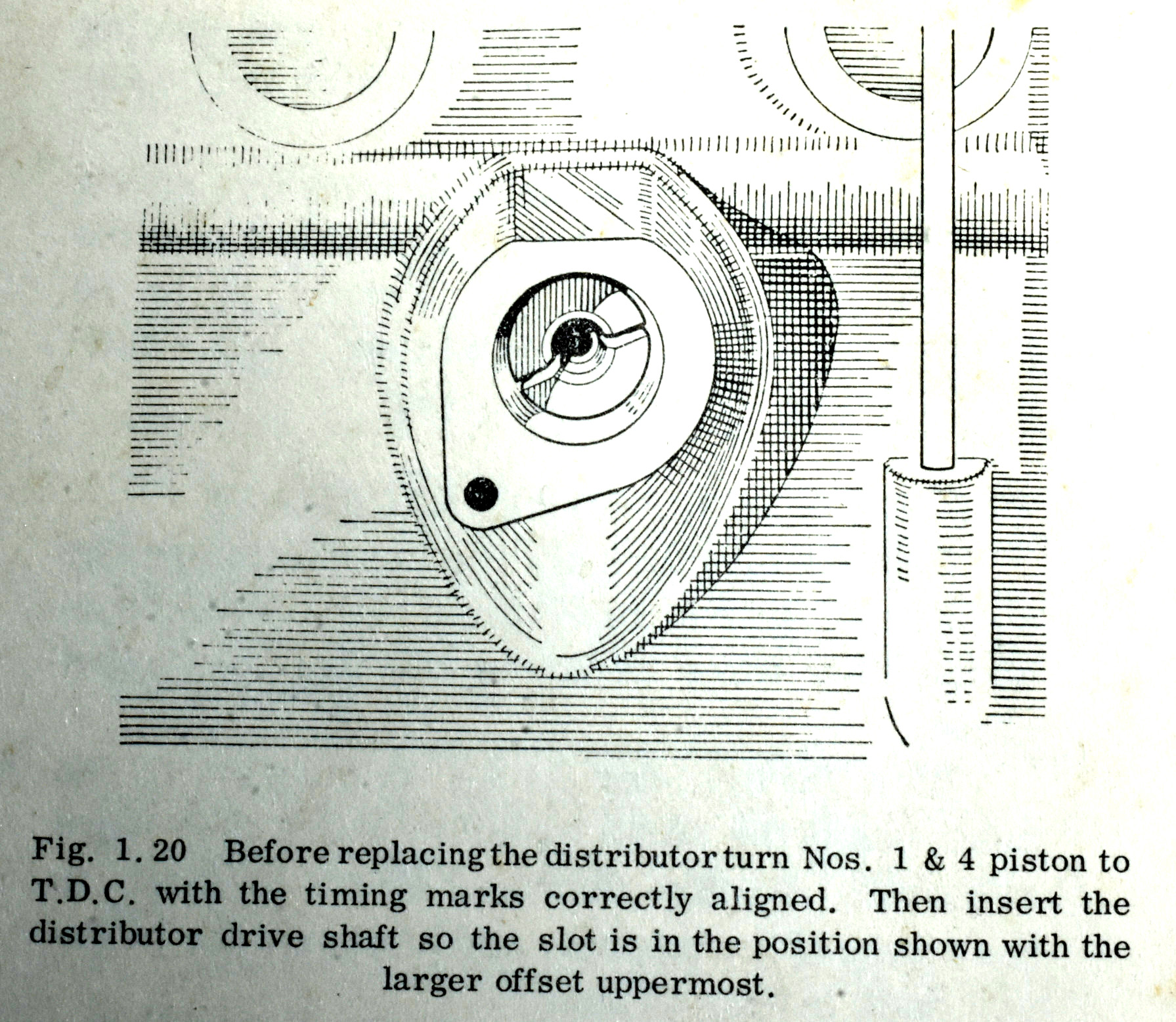

As for the drive gear from the camshaft, it does sound like that is out of the "traditional" position. This is from a Haynes manual for the MGB (closest to hand) of the position but should be the same for the 1275:
D
DavidApp
The drive gear is in approximately that location. My clock must have been tilted a bit.
