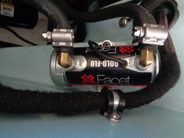

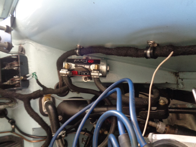

I suspect what you are asking for is recommendations for an electric pump, as you are still running the stock mechanical pump?
If so, the best one I could find is a Purolator Facet Gold. I blanked off the old pump with a plate and gasket and mounted the new electric Facet down in the engine compartment on a side frame rail. It pulls fuel nicely and I can keep a cheap 12V pump with alligator clips in my spares bag in case I have a failure. Couple of ty wraps and move the fuel lines, clip on the battery and good to go.

Rick_Thompson
And yes, I did not use any relays. Attached at the fuse block on terminal that is hot when key turned on, and I also used an inline fuse.
