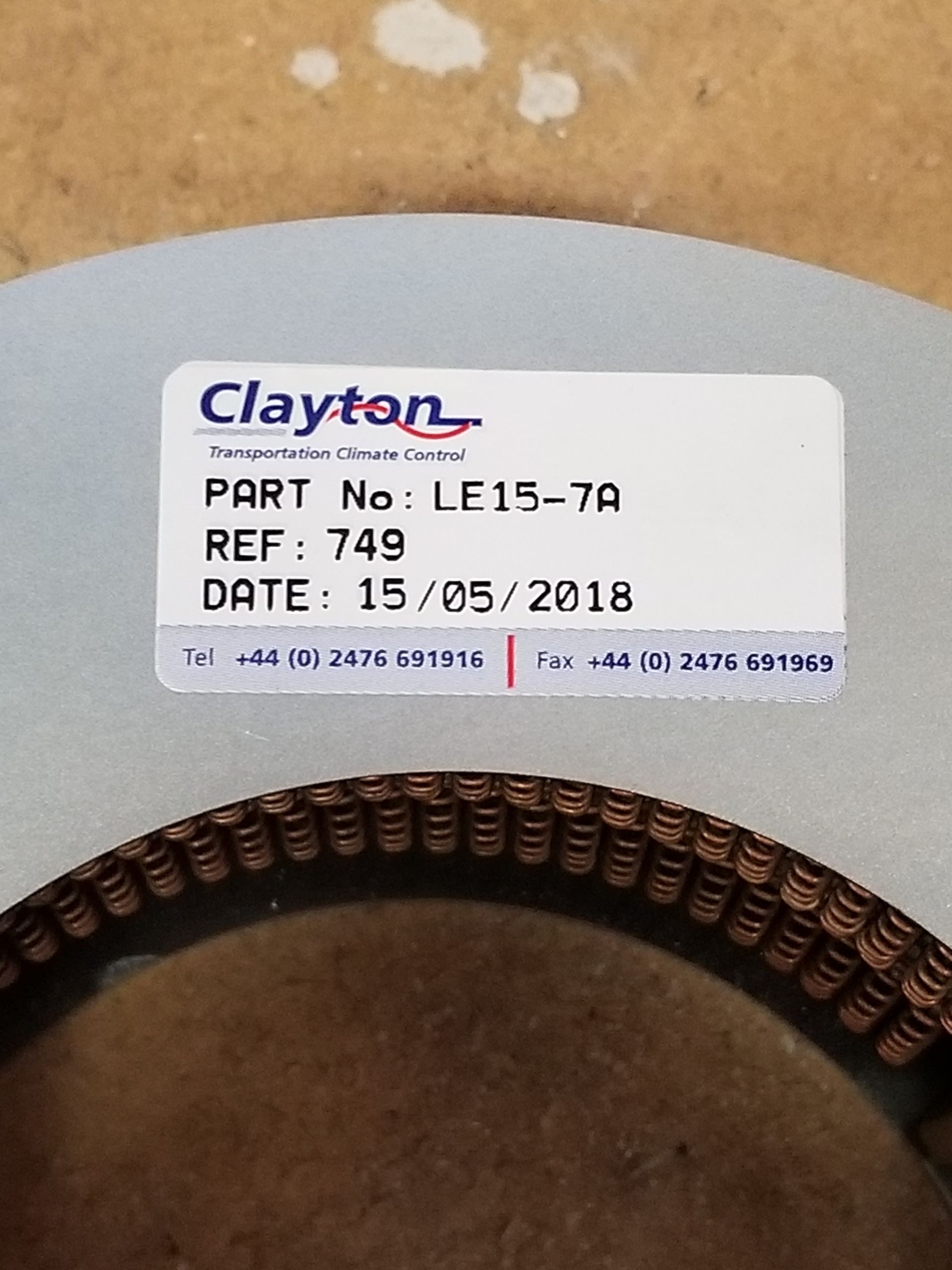

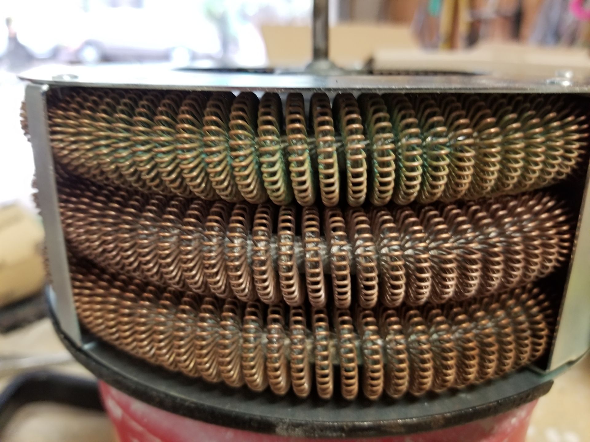

If everything else on the heater is good you can get a modern heater core. I got my one from the UK.
It works great.
Moss sell the core but it is way cheaper from the UK.

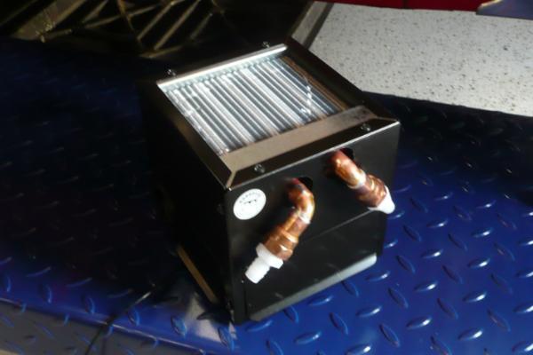

I went with a unit from Maradyne, basically a truck heater:

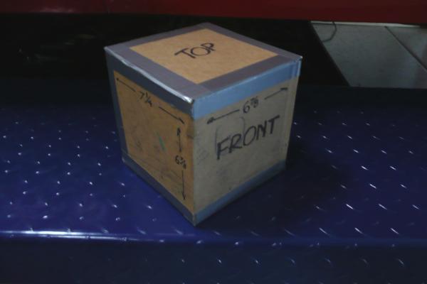

To fit it I made a cardboard mock-up:
Had to rotate the core 180° to have the pipes present rearward. Sweated on some elbows and added barbed connections:
Seemed to produce a lot of heat though I didn't live in the frozen far north.

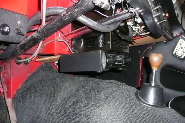

I followed Geo's lead and installed the Maradyne heater in my TR3. I got mine at a very reasonable price. It does require some rework as Geo shows. With soft top and side curtains on it will very quickly warm up the inside of the car at only the #2 switch speed setting. At the #3 setting it really pours out the warmth. I also did not install the defroster pipes. It warms the inside of the car quickly and I found no need to use the defroster. Being from Raleigh, NC the weather gets quite cold, but not terribly cold.
