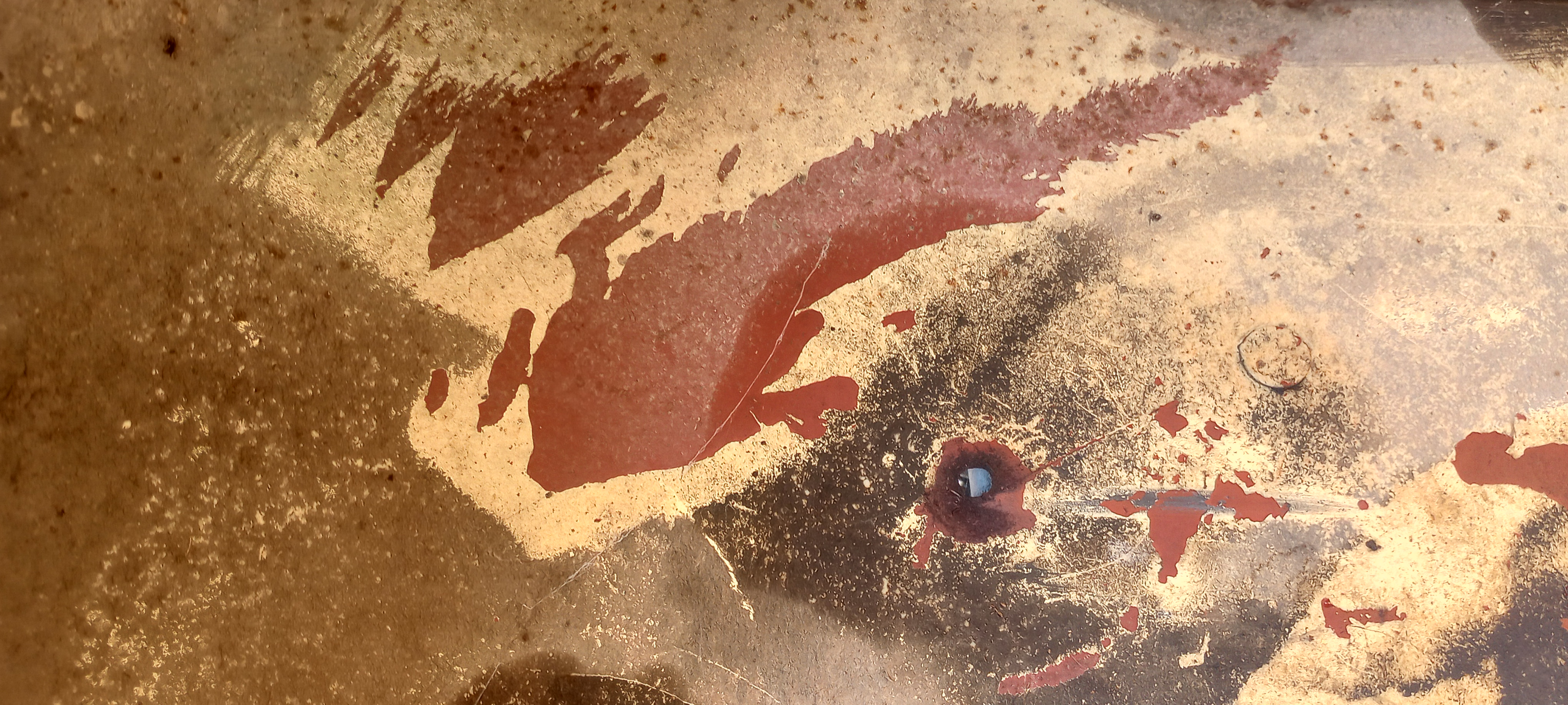

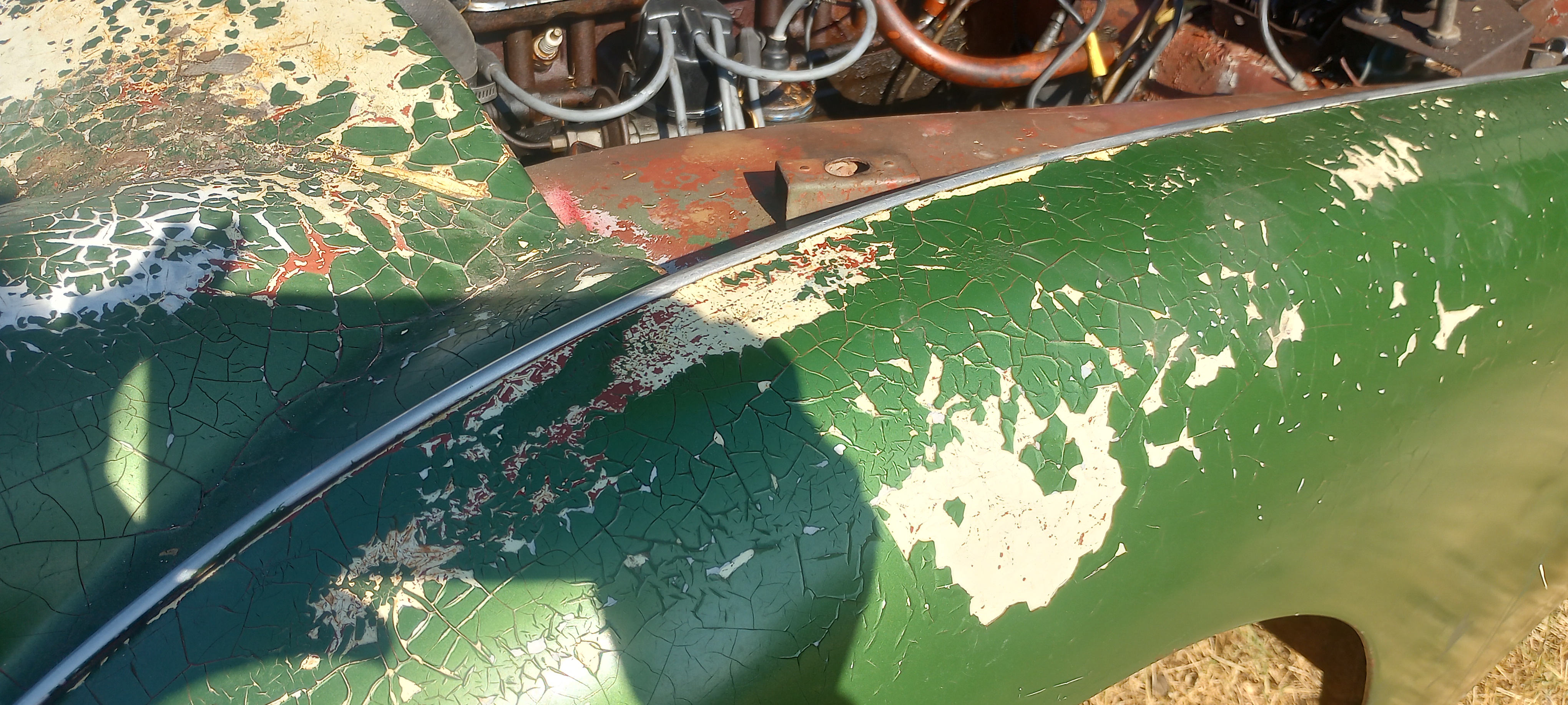

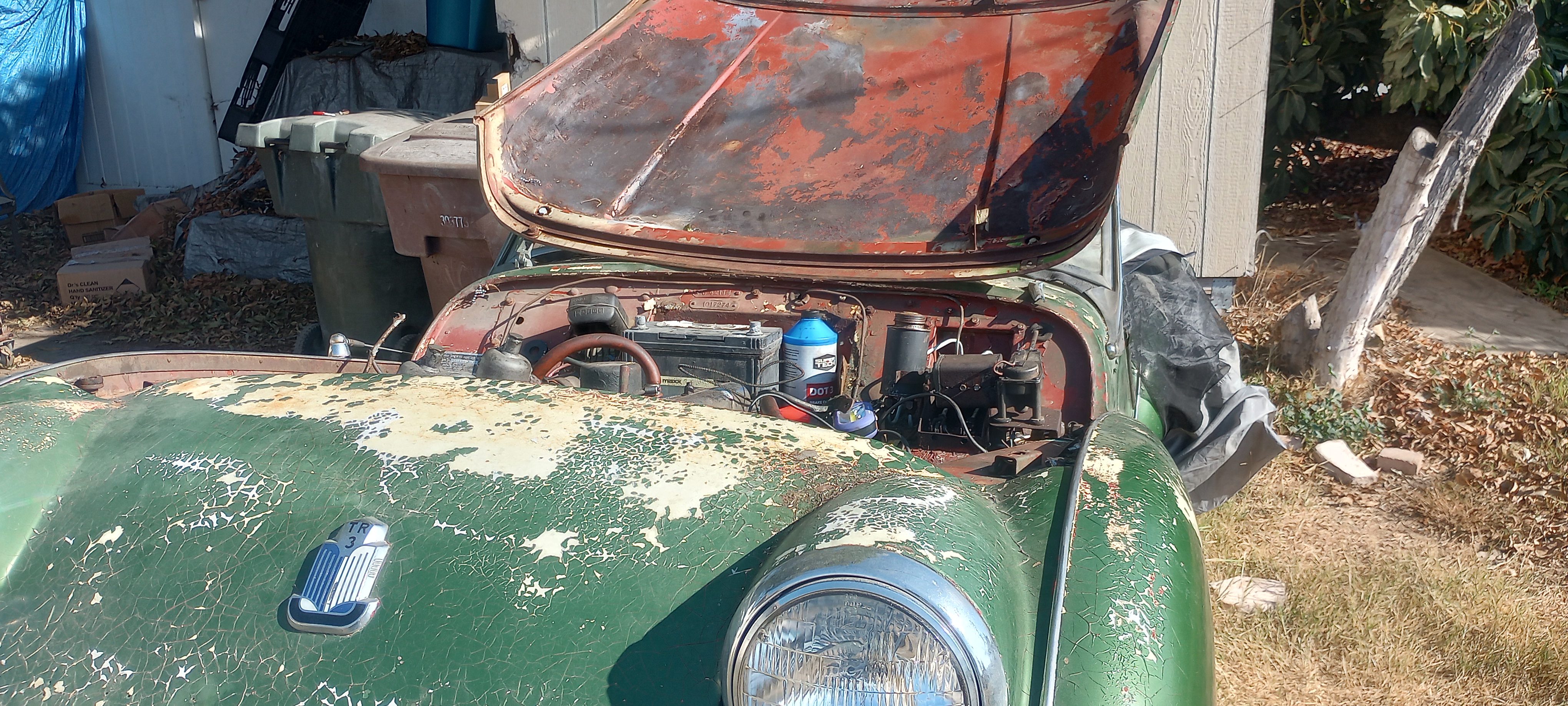

Please help me identify the original color of my car. Currently it is green, before that yellow and below that red or maybe red primer. Any advice where to find the definitive original color?

Most reliable source:
Original data from the original factory records.
Tom M.
sp53
I am going to guess Primrose Yellow. Yes get the certificate; easy to do if you send them a picture of the vin; they send you nice letter it tells body color interior color, and more plus options the owner might have had put on.

CJD
The British Heritage Certificate will be the definitive source for original color. To get a preview, look up, under the dash, as that is rarely re-painted...also behind the boot panels around the fuel tank.
From what I see, I'll put a couple bucks on yellow!

lram59
Member
It doesn't appear to of ever had a detailed repaint so just look up under the dash and you will see the original color. Take off a bracket or two to confirm. The boot and bonnet areas may have been reshot but hardly anyone will do much if any of the under dash area.
