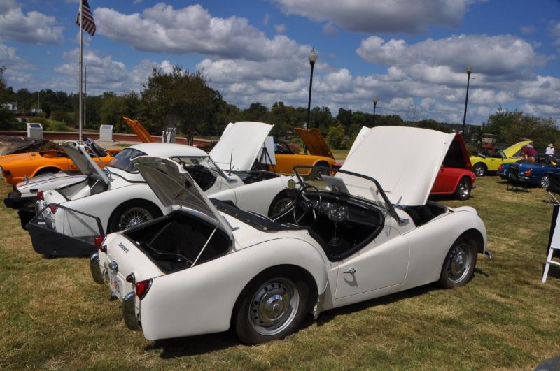

DavidApp
Two white TR3s. The colour difference is slight but was discernible. Mine the closer one has a more yellow tone to the white. It was taken from the GM code for Dover White.
David
