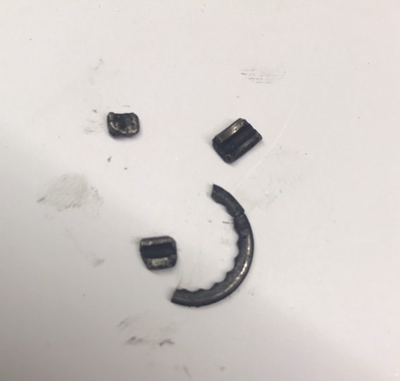

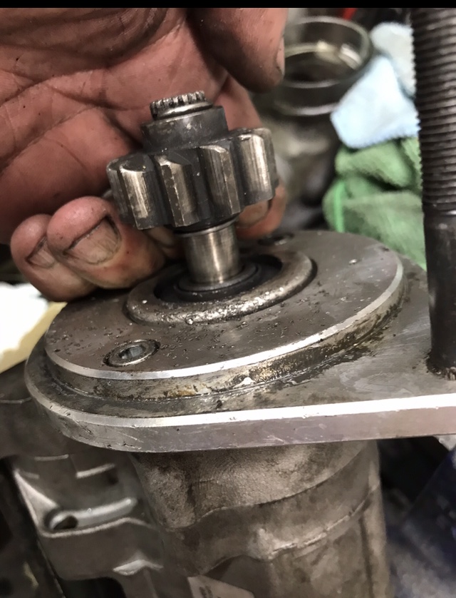

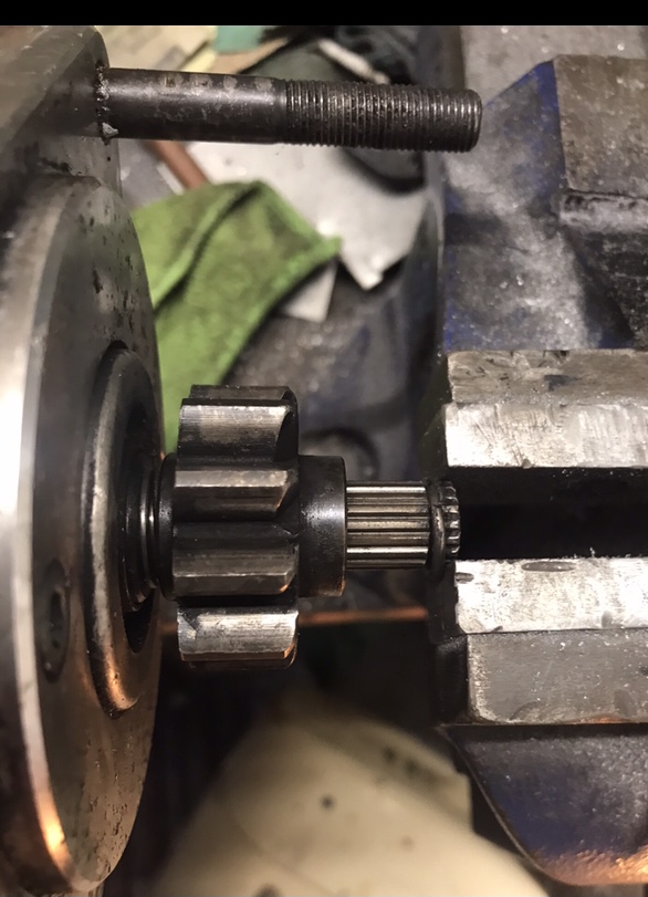

Hamish Racing
I had similar problems that got worse and worse until it would only push or bump start.
It turned out to be the starter ( hi torque) pinion securing ring.
It had broken up.
thus sometimes would engage on the starter spline thus turn the engine. But later not leaving the starter to spin.
Replace couple simple parts and all is good.
