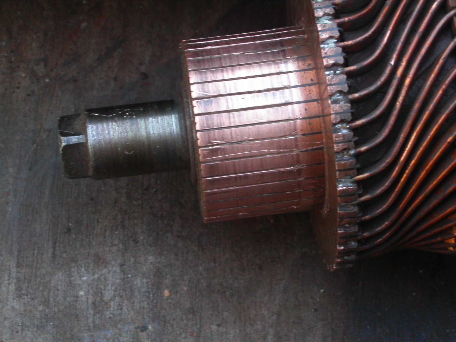

DougME
This was my Land Rover but Lucas starter nevertheless.
