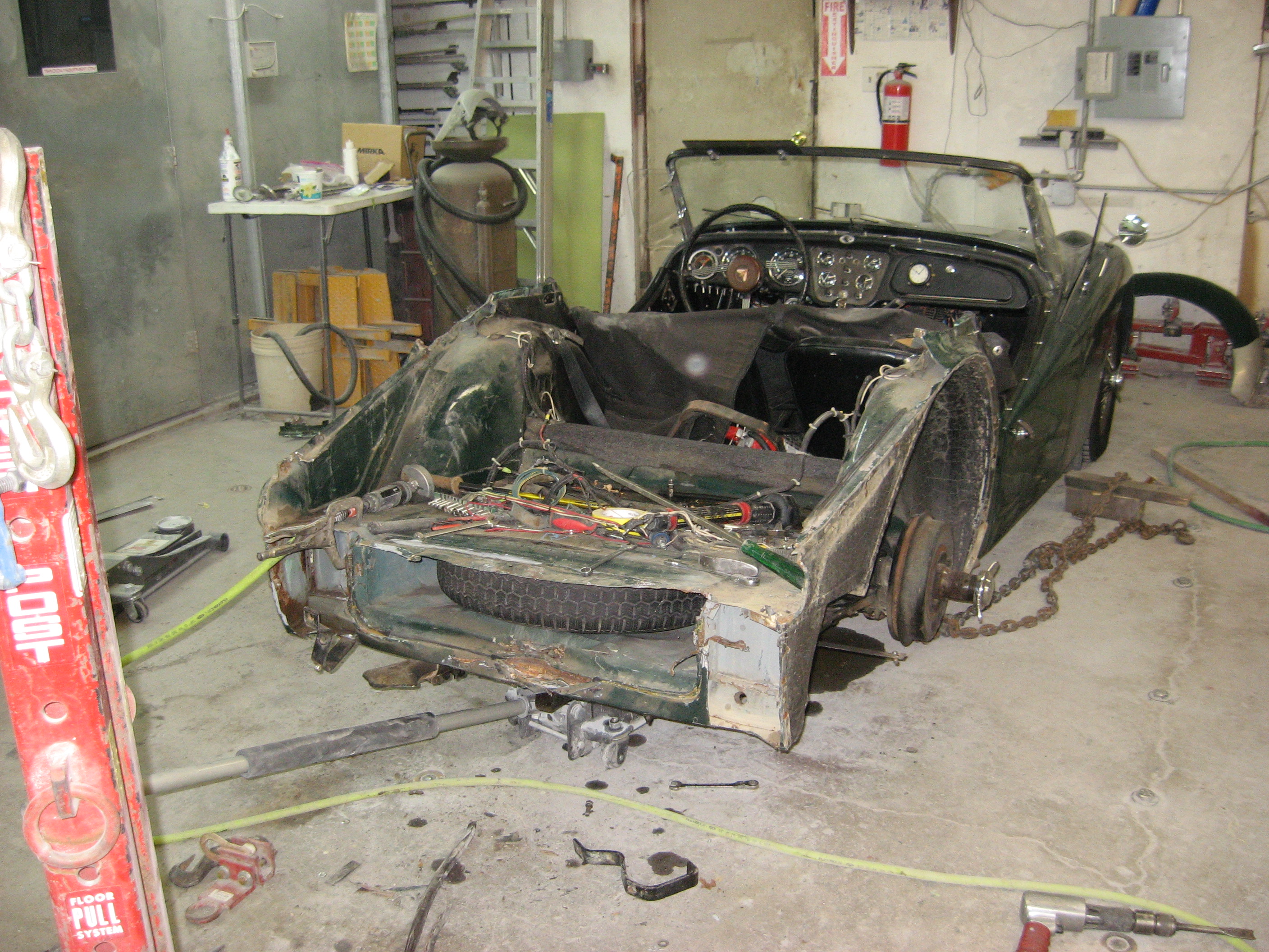

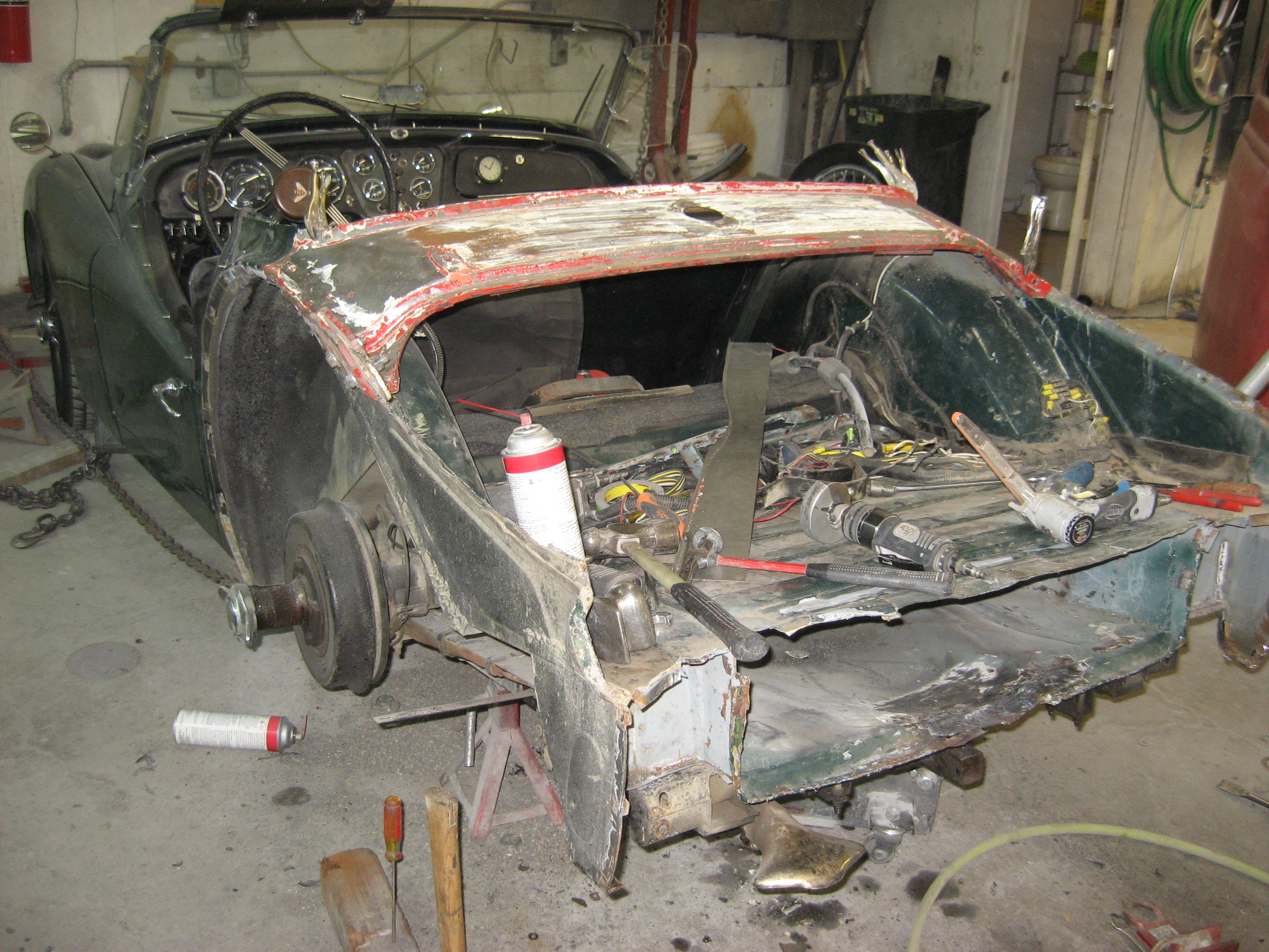

Dont be this guy (12k rear ender)
Mad dog

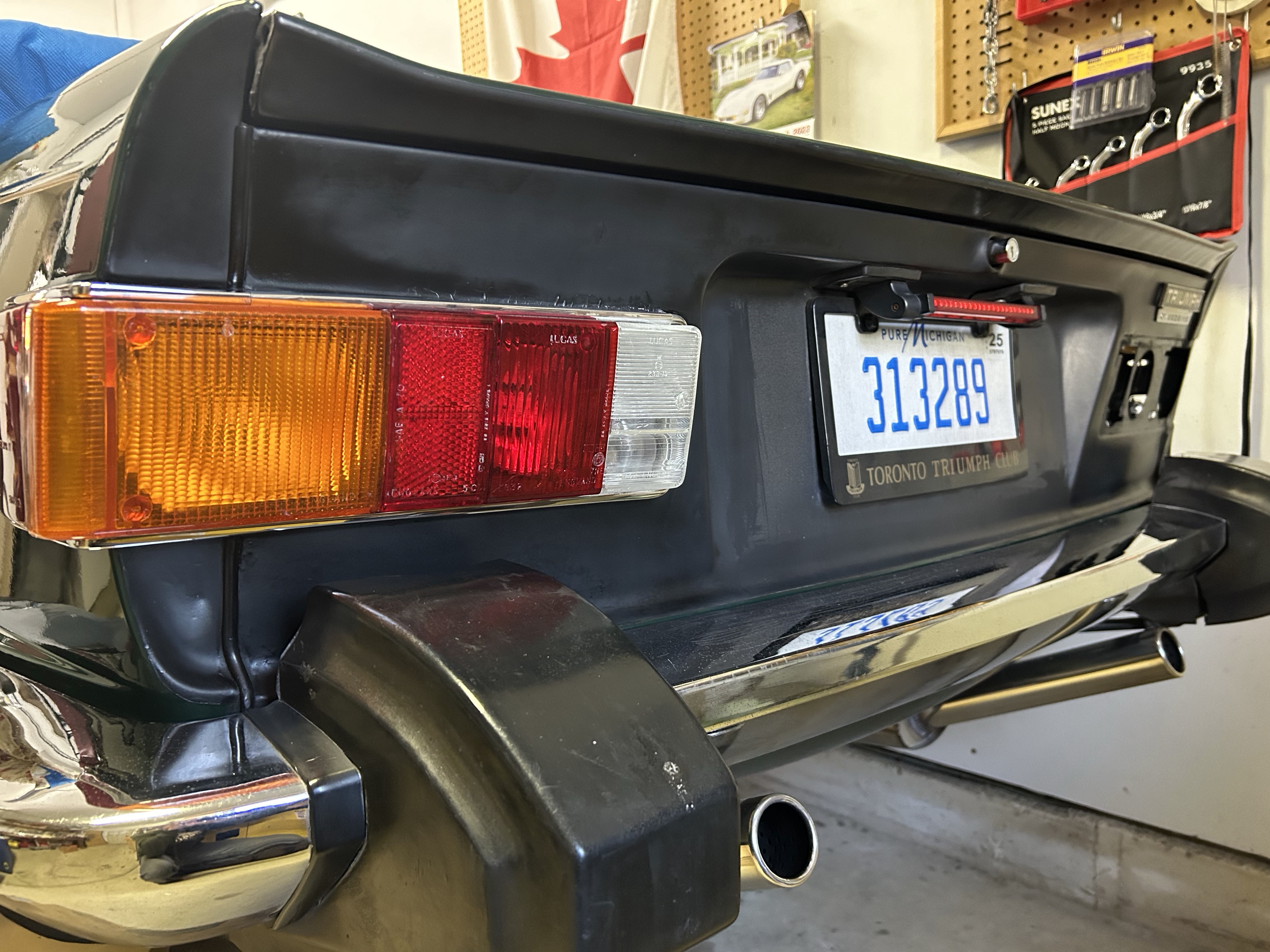

TR-3rg
Hi,
Optronics makes a nice red LED strip light. They come in a couple of sizes, 9" to 20" by 1.25" wide. Google Optronics Streamline LED Trailer Tail Light. They are submersible and cost less than $25. I have a 16" on my roll bar.
Roy
