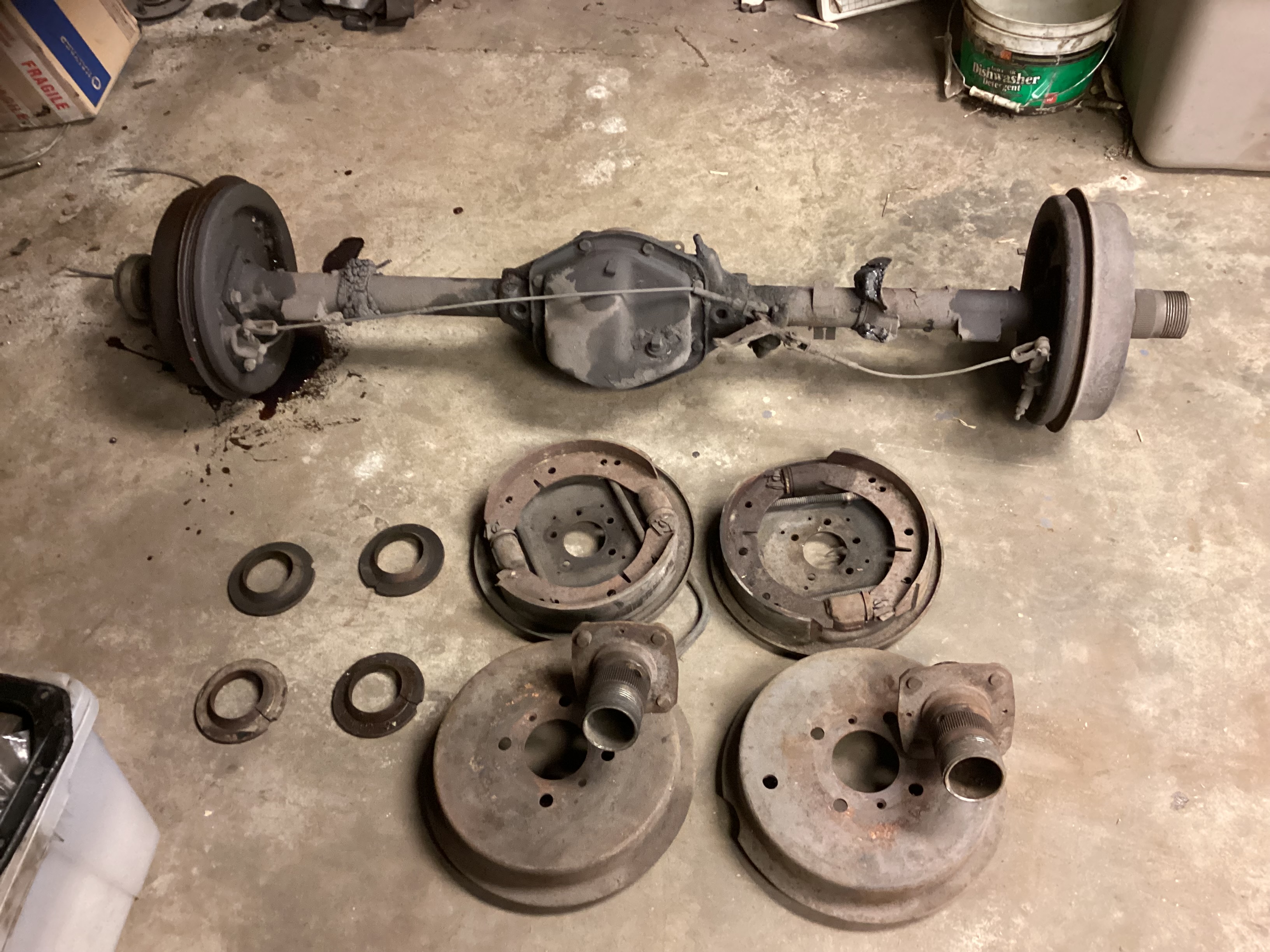

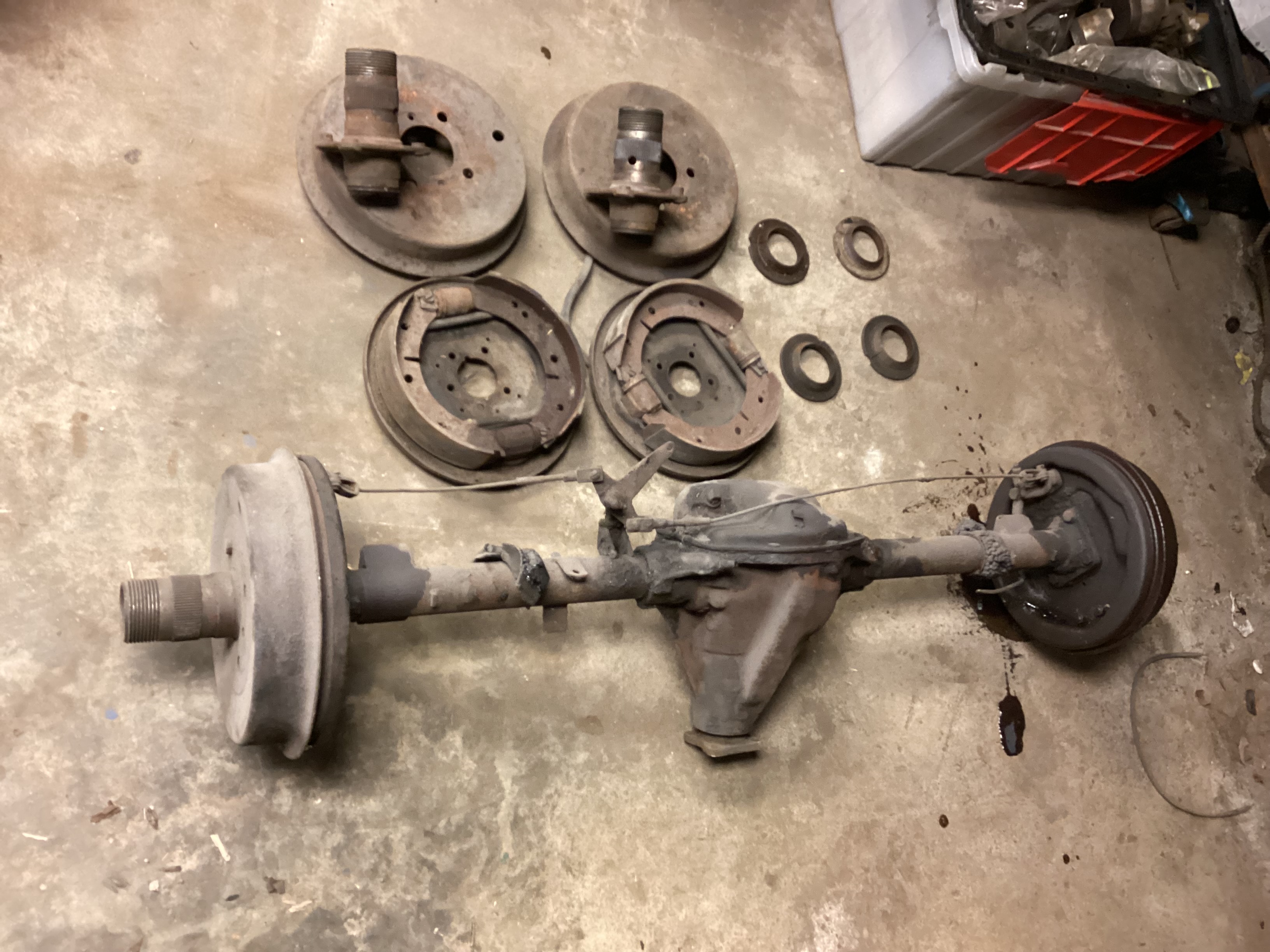

TR2 and early TR3 had this hub set up for wire wheels. Theres a special spacer used, which is near impossible to find. I have the whole set up I will sale. I kept it thinking I would find a TR2 to put them on. PM me if interested
