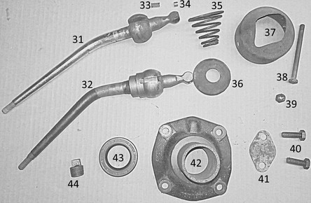

I have 2 seasons on my J Type OD tranny transplanted into my TR3A. Shifting difficulty I have had is finding 3rd moving from 2nd and also cleanly down to 4th. I want to remedy and in revisiting my conversion I have a few thoughts on cause. Without enough downward pressure by spring, the shifter end migrates up the shoulder of rail?
The profile for the TR6 shifter shows a collar raising the large spring thus tensioning under cap? The flat ball type of the TR3 could be not giving enough downward spring pressure? Also I read about a rubber hose and washer placed under the top cap as a fix to add a limiter under shifter cap? How did this work?
If I do need to change to a TR6 style shift ball arrangement, I was toying with the idea of removing the longer curved shifter handle since I think it's splined. I could cut off a straight TR3 handle and possibly weld to the TR6 ball unit?

In a previous thread about TR3 shifters used with TR6 transmission, Randall made a couple of comments I was hoping to get background info on?
There is reference to a TR6 Service note-
"Instead, I'd be putting a spacer between the top of the ball and the curved piece on top of the big spring, to limit how far the ball can come up. I think it still has to come up some, but not as far as the slot allows. There's a service note about putting a length of heater hose in that location, which likely would solve your problem."
Also as I posted in pic above showing two TR6 shifters used, does anyone know when the change took place for the addition of the collar piece on top of the ball also Randall noted?
"As shown in your diagram, with the original TR6 shift lever, the top of the ball has a smaller section that sticks up through the spring, and limits how far the ball can come up. But, the OP has a TR3 shift lever in a TR6 top cover, and the TR3 shift lever is shaped differently in that area, which allows it to come up higher."
