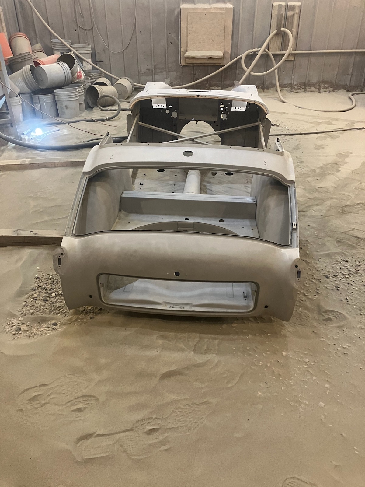

I cut out the spare tire compartment in all my cars so I can fit a larger spare wheel. This is a smallmouth TR3 I an restoring. Just back from the blasters and you can see the compartment in the picture.

Those are my thoughts also John. When I look Auprichards car I want to trade him for something. That looks like a nice sold tub Auprichard. The one I got is in poor shape and if I got it blasted it would be worse. I was impatient when I bought it cheap and should have known better by know.
