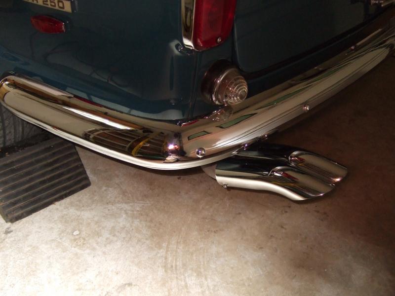

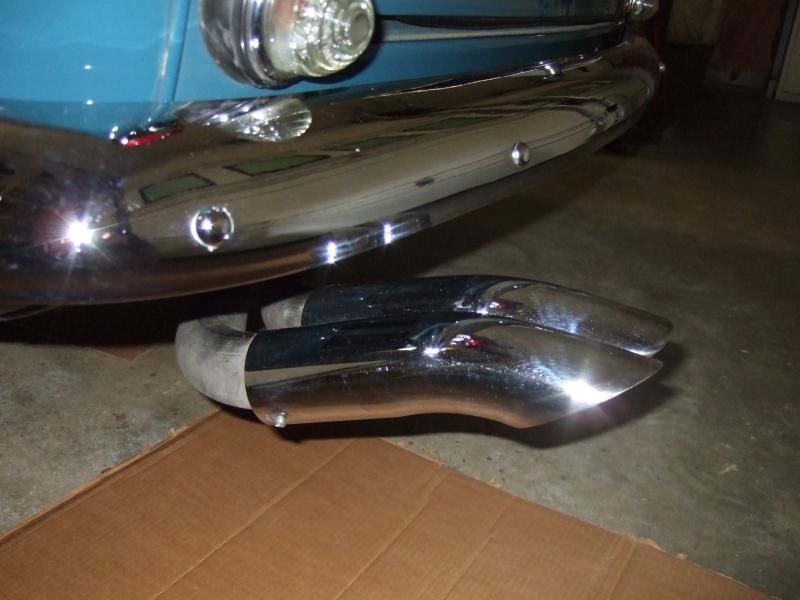

Here's a picture of some I put on my TR250. I put them on primarily to keep the exhaust off the chrome bumper. They taper down from the top to hopefully shoot the exhaust down toward the road. They are 2 inch inside diameter. I got them at a local parts store, I think it was Advance Auto Parts. The are held to the muffler outlet pipes with a couple of screws that tighten against the outlet pipes.
