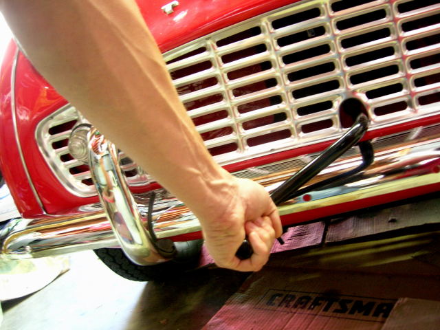

My crank dogs are at about 10-4 as the manual shows. When the #1 piston is at TDC the crank is at this position. (See picture)
Should I get the crank handle to be about as shown or slightly lower and more before TDC?
I am right handed so I will have that hand on the handle.
Should I use both hands as shown?

In 1967, My TR3 lost its starter solenoid. Incredibly the Oldsmobile/Triumph dealer had to order one. For the better part of a week I used the crank to start never thinking it might hurt. It did'nt. With the compression starting at about 7 o'clock, just a quick short pull up was enough to easily start a reasonably warm engine. The Ford's Model T crank is a different story.
I had the starter fail on day 1 of a 7 day trip so I got a lot of practice with that crank.
I use 2 hands cradling the handle as you show. If the engine is hot it starts almost effortlessly. For a cold engine I begin my crank spin at about the 4:00 position -- I think this gets be 2 compression strokes (or maybe 1 and 1/2) out of one cranking -- anyway that seems to help.

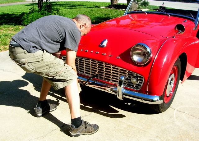

My sons and myself decided last year to see if hand cranking really would start the TR3. We never gave much thought to if it would kick back on us and I suppose we were lucky cause it started right up with each crank (we all tried it) and no one broke anything. Actually, I don't remember it even kicking back at all. Good luck and have fun.
Yep, it's fun!
My daughter took a picture of me hand cranking the car.....should have pulled my pants up a little. :blush:

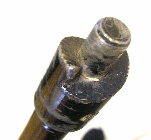

Have started it only 5 times and the hand crank dogs are showing lots of wear already!
This is a reproduction sold by Moss.
The metal is really soft.
Have others had this problem?

Mine is an original, and it looks like that too. I actually "sharpened" it once, many years ago.

I did some work on my crank handle.
The dogs wouldn't seat properly in the crank bolt.
Removed the excess paint, burrs and dents.
Then TIG welded a "blob" back on the corners.
Then using a Dremel & file put the corners back on.
Then instead of paint I used some gun bluing. Didn't want the paint getting in the way of the dogs seating.
Turned out good.
It works good now.
