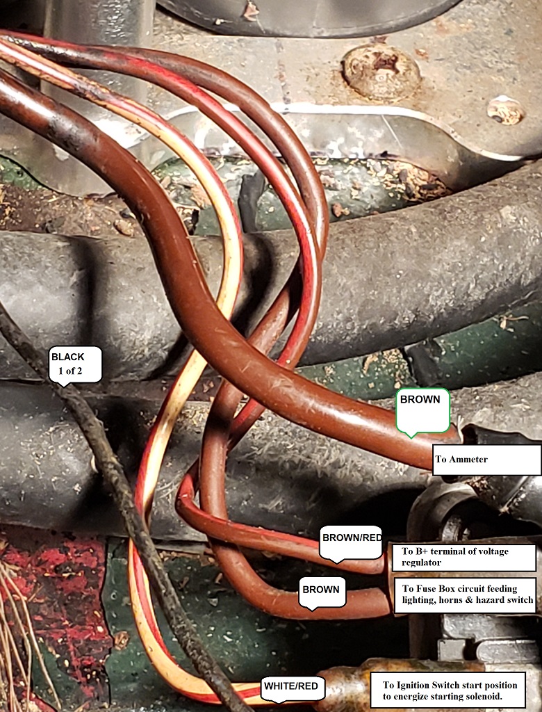

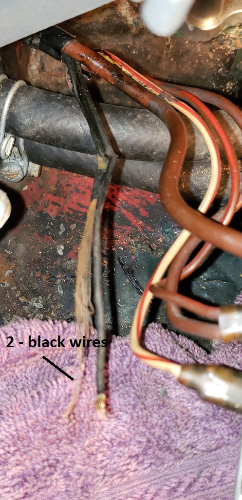

Hi guys! I would appreciate help in identifying two black wires in the bundle that feeds the starting solenoid of my 250. I realize that it is likely that these wires, being black, terminate at some earth ground point. However, I can't identify any obvious place where they were terminated. I don't see an electrical terminal with the broken ends of the black wires. Check out the attached photos where I have identified the other wires in this particular branch of the wiring harness.
Many thanks, Frank

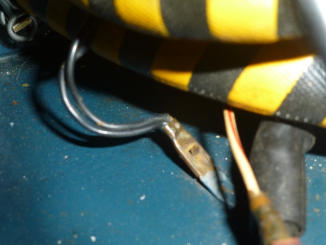

Ralph, I can't thank you enough. This is what I needed and not shown in any other manual or article that I have seen in the past. I don't know much about 6-Pack. Is this an organization like VTR or TRA with membership requirements, etc?
Again, a massive thank you!
Frank
RGK
Frank
It is a organization for 6 cylinder Triumphs, they have an annual group evet called 'TRials'; some links
