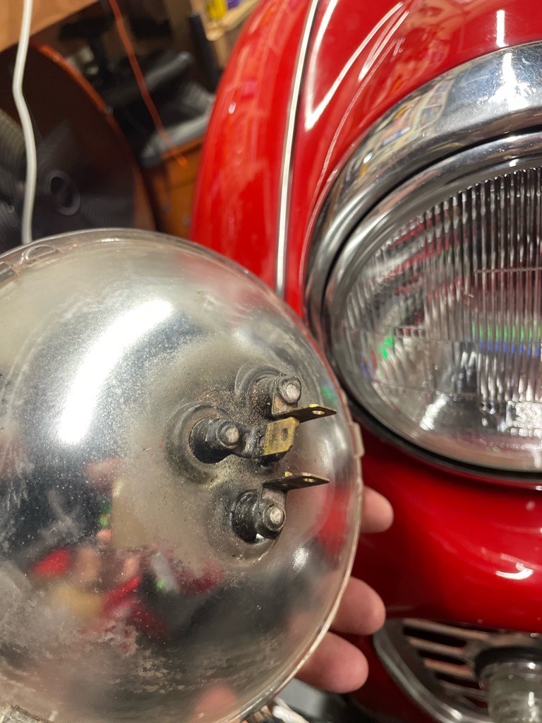

I have replaced the headlamps and tail lights on my 1960 Triumph TR3 with LED lights. What a difference!

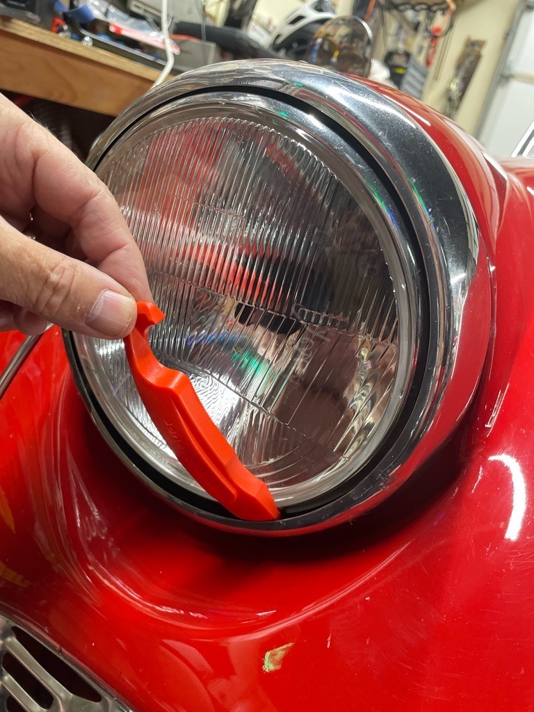

I pried the bezel open at the 5 o'clock position with a curved tool. See this link for a few more details if need be: > TR2/3/3A - Removing the headlamp bezel rim <
The entire headlamp must be replaced on this year model. The old headlamp has a built-in 3-prong connector that plugs into a 3-prong receptacle connector on the car.

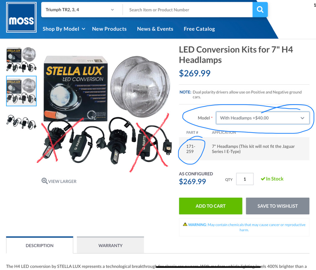

The new headlamps bulbs are as simple as "Plug & Play." They come with a 3-prong connector adaptor for the bulb. The bulb then inserts into a hollow glass headlamp provided by Moss Motors. This is why you need to get the headlamp housing for the bulb. See below for photos and Part Numbers for the headlamps.
Here is what your Moss Motors pre-checkout should look like:

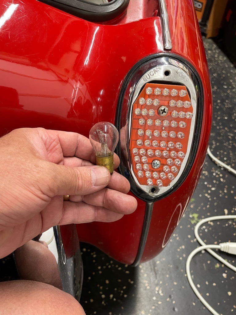

1) It tells you to drill out the rivets on the existing bulb holder. This was not necessary. Simply remove the bulb, then grab the bulb holder with pliers and move up & down several times until the metal weakens and breaks off. After all, the new LED lights are on spacers and rest well above where the old holder was attached.
The spacers did not readily fit on to the LED light circuit board. I had to trim around the outer edge of hole on the LED board with a small utility knife in order for the supplied spacer to fit into the hole. No big deal but you do have to do this step, otherwise the covering lens won't close. It does not have to look pretty. The screws hold the LED assembly and spacers in place.

This photo is from the Moss Motors catalogue. I struck through the items that I did not use with red marks.

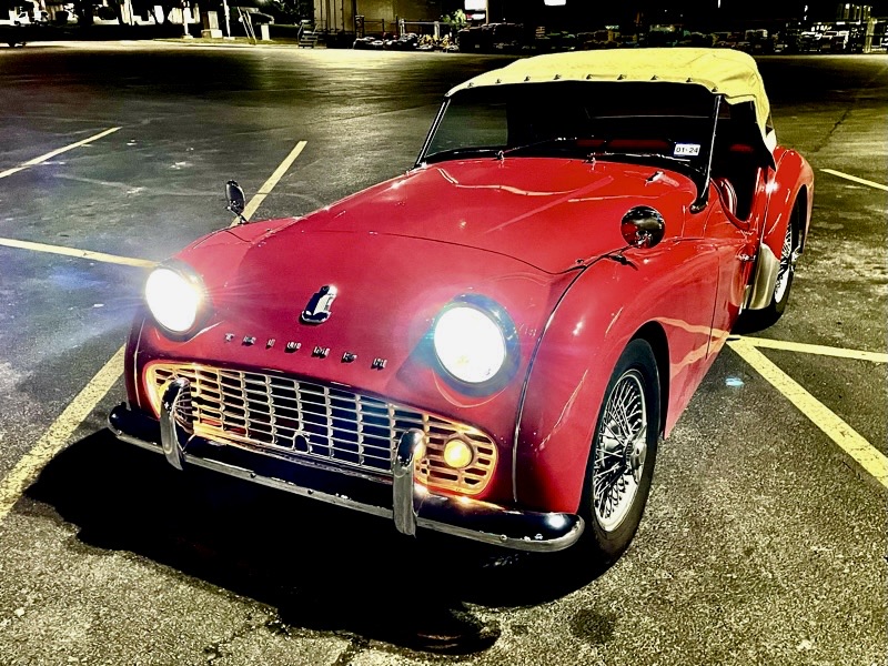

The difference in conventional lights and LED is worth the expense of the upgrade. I live in deer country and could easily see the road.
I did not take a road photo, but this photo I have downloaded from an internet search is what it looks like:
Rod-H
Bronze
Around our house the deer stand in the middle of the road and stare at you. To many folks have been feeding them from their cars, thinking it's cute. I replaced my bulbs with LEDs also, 'cause I can image what a hitting a deer will do to a TR4. I think hitting a feral hog would be worse, I think they are made of iron.
